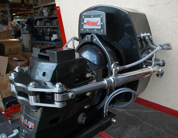

In response to rbr2328, Wiggler is correct. Konrad also offers an extension box that locates the transmission inside the box.
Konrad offers several length stand-off boxes. Our most recent addition to our line has been designed as a direct replacement for any vessel that was originally designed for Bravo appplication only. (no room to move the motor forward)
The dimensions of this unit are very similar to the Merc ITS and can be bolted in directly in its place.
