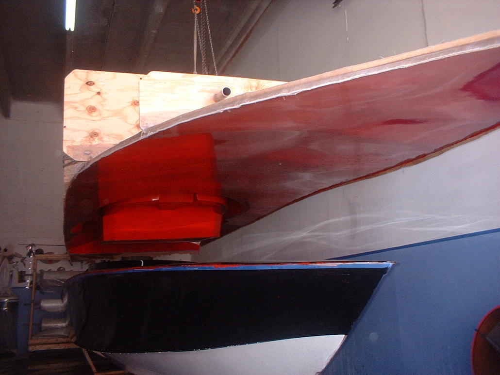

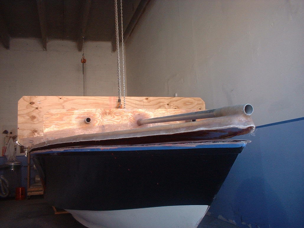

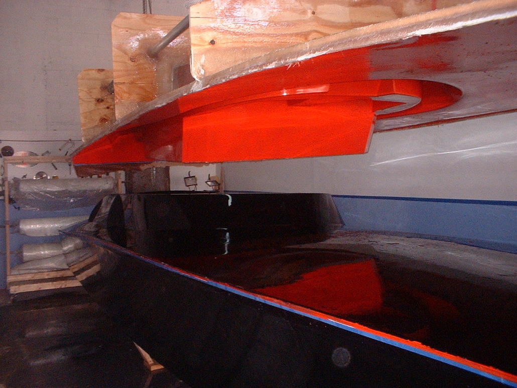

Old 02-26-2010 | 07:46 PM
Lauderdaleboats's Avatar
Joined: May 2005
Posts: 409
From: Florida
Default More Pics
No problems releasing the mold. The finish in these pics is the PVA still stuck to the gelcoat. I washed a few areas and the finish is beautiful. The whole mold needs a good wash down to remove the reat of the PVA.
