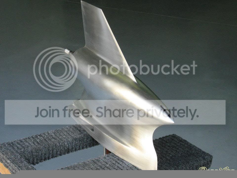

My Imco shorty has been getting cavitation burn for awhile now. This year it finally got so bad that it had eaten half way through the housing. After doing some research here and on other forums I decided to weld up the damage and modify the water inlet. My welder closed up 3/4" of the rear of the inlet and filled in the eroded area and I opened up the inlet toward the front. I've seen this mod done before and some have said that it fixed their cavitation burn issues. While I was at it I sharpened the leading edge of the lower and cleaned up the rough surface quite a bit. The castings of these lowers seem to be of a poor grade of aluminum and they are also porous. I had high hopes for this fix but after less than 2 hours of running on plane I have signs of the cav burn again. The larger holes in the "after" pics are from air pockets in the weld. My welder will fix this but if the cav burn is going to continue then I need to look further for a cure. I've looked at a few of these lowers on other boats and every one had the cav burn. Has anyone moved the water inlets to the top of the bullet and filled in the stock inlet? Any other ideas? I am stumped. The first pic is of the burn before I had it welded up. The next two pics are of the lower after I reworked it and moved the inlet forward. The last pic was taken today and shows signs of the erosion starting again. The larger holes are from problems with the weld.

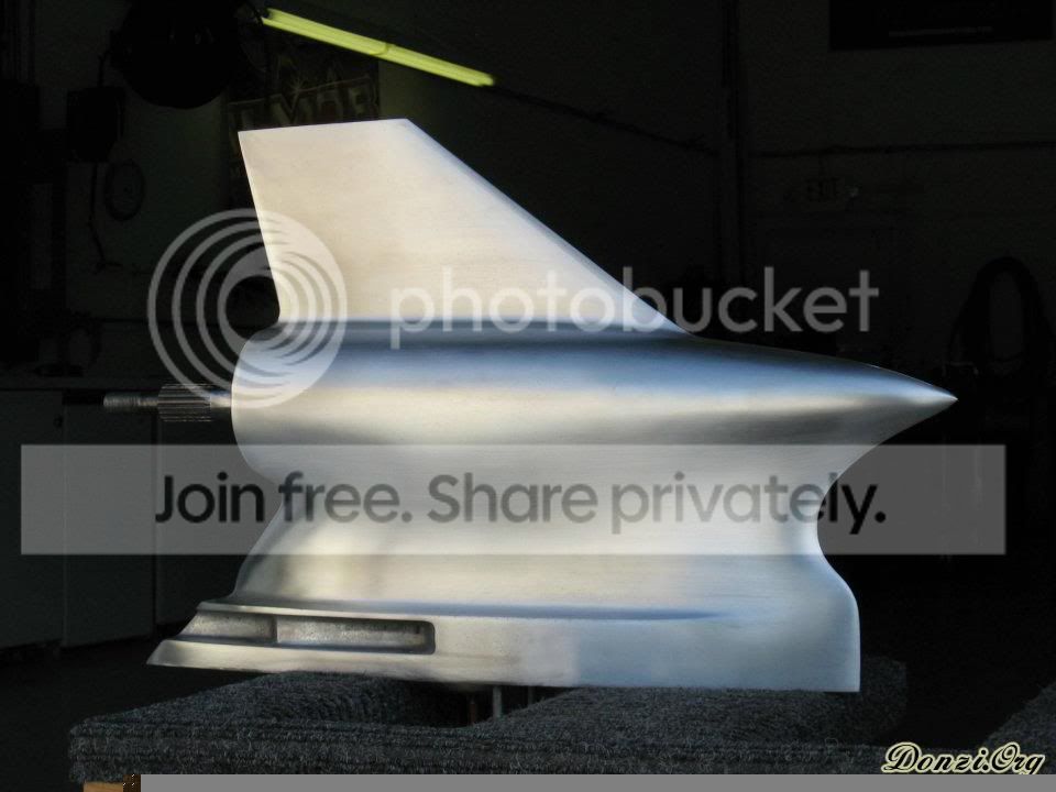

I have pics of an Imco blueprinted by Wilson and that is what I used as a model when I did my work.

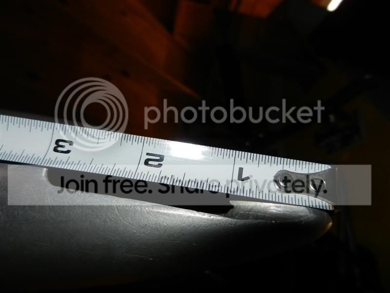

Here are more pictures. The first 2 are of the Wilson Imco. They look very similar to the two pics of my reworked lower in my first post. The second is of the inlet before welding it up. I was also losing pressure when trimming up and rounded out the front of the opening. I had the cavitation burn problem before and after I did that so that was not the cause. That was done per Imco's recommendation. The last pic is of the lower after welding but before finishing the work on the inlet.
