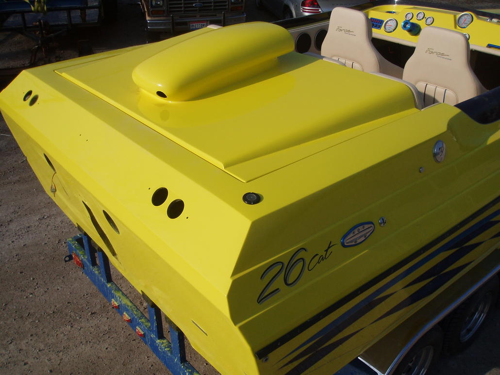

No matter what i do with my engine i will have to redesign the engine hatch . The engine sits high and the flame arrestor already is up in the scoop . Headers keep it from closing by about 1 1/2" . I need something low profile and sleek looking on the sides and aft that will also afford splash protection . The forward section needs to be high enough to make rear seating comfortable and nice looking . The top part of the engine and headers will have to be exposed and should look hot that way . Any ideas on how to go about this ?? At this point i am at a loss because this is something i can't do myself and it look moffesional ... Boats = Change one thing and then you must change ten other things to make it work !!
PS: Lightweight but strong would be a bonus , this one is really heavy and ugly .

did one similar to that several years ago on a Force Cat. Quite a bit shorter but similar none the less. Are you looking to do finished glass or upholstered? lightweight and strong is not a stretch these days.
Attached Thumbnails Engine Hatch Redesign-hatch-028.jpg   Engine Hatch Redesign-hatch-026.jpg

the deep. Can You post a picture of the hatch open. That would show more of what You need. I'm sure Glass Dave can build a beautiful lid. Artie
Finished glass or upholstered , at this point i'm undecided . That hatch is very similar to what i have in mind minus the scoop .

Finished glass would look great on Your boat. IMO. Artie

Finished glass would look the best, however a foam pad and vinyl would most likely be cheaper

22 Eliminator Daytonas had similar hatches to yours and I never did like them. Not a big fan of the humped up type hatch. Just looks out of place. On my buds 21 daytona jet he went with 2 half hatches that go around the motor/headers/blower vs over it. It looks much better than the hump. I believe they are hinged to open toward the sides of the boat and are easily removable. I will try to dig up some pics
