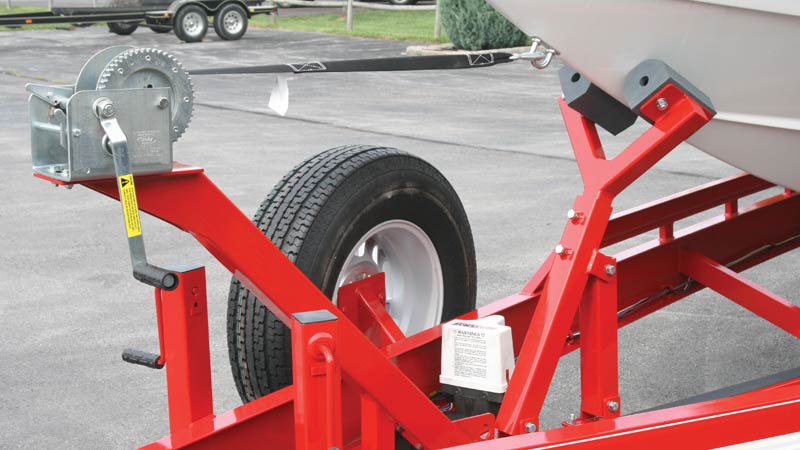

I am still learning, however. Did the damage at PB2 at Loto....trailer was too far in, so when I drove on and hit the bow stop, the carpeted area was in contact with the red paint. When I pulled out, it rubbed hard and smeared the paint...actually totally rubbed it off in a 1/2" x 2" section on each side of the bow.
That is the only thing I do not like about Ron's trailers. I hate that carpeted block up there.
If it were me...
I'd call Loadmaster Trailers of Ohio have have them send you this bow catcher:
http://www.loadmastertrailerco.com/options2/
[ATTACH=CONFIG]504936[/ATTACH]
You can call Myco and they will also send you the same, but it's fixed--not adjustable. IMHO, the Loadmaster version is better than Myco even as the Myco has the rubber/silicone blocks sitting in a small cradle with steel sides. The outer sides can damage the hull if you come in really crossed up. It happened to another Myco owner I know.

Loadmaster will sell just the rubber blocks if you want to modify your existing bow stop to the rubber block stoppers.
