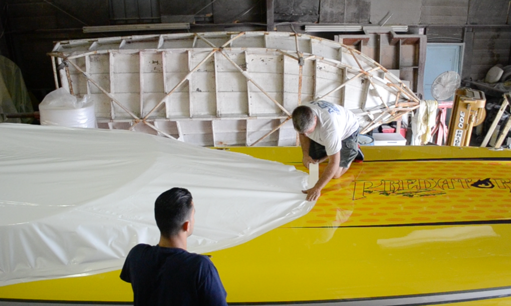

When delivering painted or dark hulls, you want to protect the hulls surface. If sand gets between the shrink wrap and the hull it will damage the surface and will act as an abrasive the whole trip so we minimize the amount of shrink wrap to prevent this. Your shrink wrapper should only wrap the cockpit to prevent water from going into the cockpit. If you have a cockpit cover so much the better.
Then we put this film on all leading surfaces that would get damaged by rocks flying/bouncing on the road. As Speicher Lane said you need to get a self-adhesive protective film. We used Neil Lawson's (president of Shrinkwrap by Euroglass 800-423-1159) This problem occurs mostly on painted boats or dark
colored gel coated boats. The solution is the use of anti abrasion film or tape
Richard's yellow C30 Predator with cockpit-only shrink wrap.
