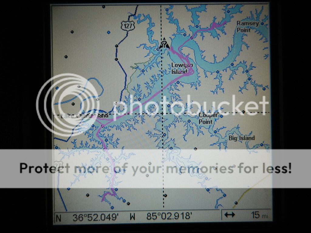

A few years ago when I needed a tow I didn't know how to read out my location. I told him I would just read what it said. That worked but I still don't know how to read it out. Isn't part of it in "minutes?" Here is an example pic with the coordinates at the bottom. How would I read it out over the radio?

It looks to be in degrees and minutes. Seems your decimal is showing thousandth instead tenths. You should be able to change the settings. You could just round to the nearest tenth.
36 degrees 52.0 minutes N
85 degrees 02.9 minutes W
That's how I would read it out.

Tree-Six degrees, Fife-Two point Zero-Four-Niner minutes North. Zero-Eight-Fife degrees, Zero-Two point Niner-One-Eight minutes West. You could always move the North and West ahead of the Lat/Long if you'd like. Report the Lat first followed by the Long. This is how the Coast Guard passes it over the radio, I'd recommend using their technique. For clarification, 3 is pronounced "tree", 5 is "fife" and 9 is "niner". This is for radio clarity, so numbers aren't confused with words like 'fire' instead of five.
