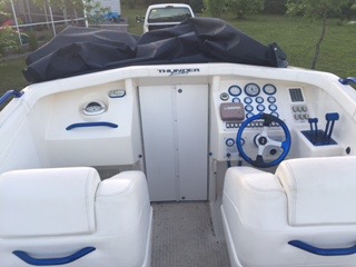

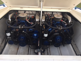

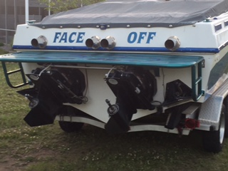

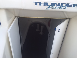

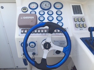

Guys thanks for all the advice and feedback. I just bought a boat that some surveyor flagged with a soft transom. I went into the deal knowing it would need to be corrected. Boat i went with is 1996 Active Thunder - Thunder 32. has 2 merc blue 450's & B1's w/o props. There are minor blemishes here and there but otherwise it is really clean. I personally saw or felt no issue with the transom, but I admit I am not an expert. I plan to use the boat in a relatively gentle manner until I get the transom issue resolved and I will be keeping an eye out looking for any sign of flex from the drives. I know, useless thread w/o pics, so here goes;

Looks like a pretty solid start.
Good for you man!
Keep asking your questions and have some thick skin. You'll be fine.

If I was a stirrer (which I'm not) I'd suggest renaming the boat to "Transom Off".
Looks pretty tidy and you're prepared for the worst case scenario if necessary. Good luck, hope you get many seasons of enjoyment in your AT.

RR - absolutely prepared and this contingency was baked into my offer. I don't if it means much, but we had some big guys on the swim platform at the same time and since it is bolted to the transom might that be a good sign? I suspect those aren't the areas that go soft first.

What are thoughts on the blue merc 450? Are these pretty stable engines (built from a BBC 454?)? any further tricks to get some cheap hp out of these? what rpm do these top out at, around 52-55K ?

If the exhaust has not started the rot than most likely any rot starts down by the drain plug. Good thing about having twins is they are mounted higher and spread away from ground zero of rot.
Trim the drives down and step on the cavitation plates and bounce on them while a buddy watches or videos it.
If they move at all it's the start of the problem.
The parasail boat I referenced earlier is spinning a Bravo 2 pulling a parasail that is equal to 4000 pounds of pull sometimes, so a Lot of pressure is put on the transom .
You will burn up the couplers before you will sink the boat from a rotten transom.
