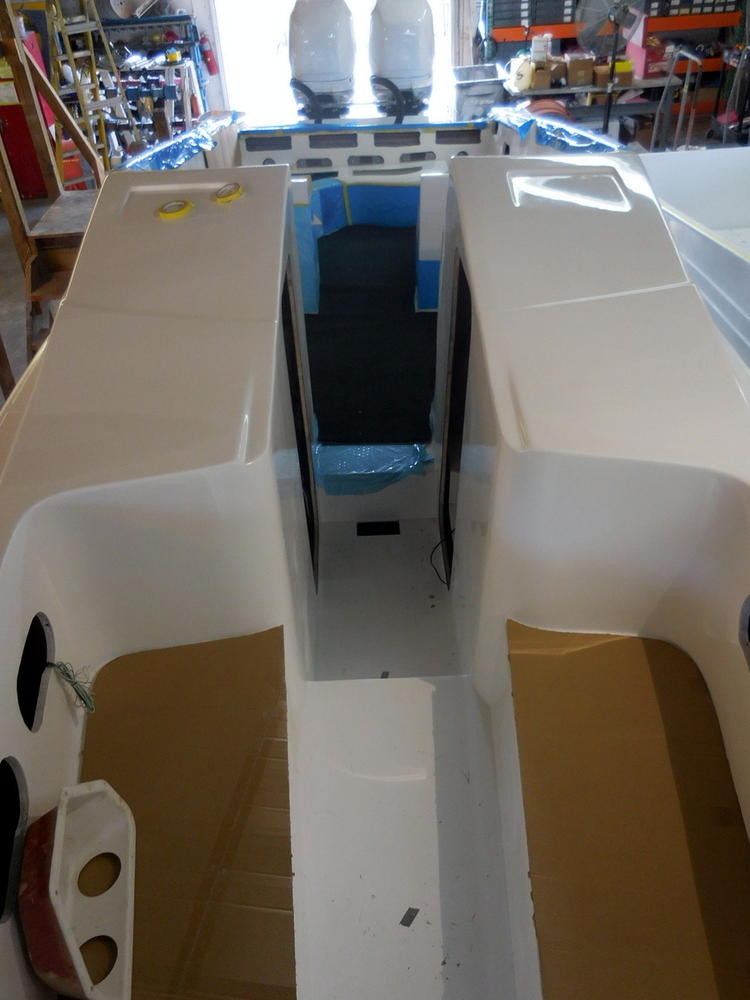

From another thread in the Active Thunder section::
Ironically I just took some pictures and sent them to him this morning. I have been quiet about this since the project is taking time to complete. I didn't want to put anything out there until we were about 30 days away of the debut.
Since the tooling for the basic boat was complete we had to go back and design and build the dash pods from scratch as well as storage boxes for the front seating and the enclosed head. Also, even though we had made molds for the back seats of the 33, the cockpit seat molds required modifications for the 29 due to the fiberglass cockpit liner's size.
Here's a couple of teasers for you.
Sorry I don't see that being marketable. Looks like an idea from 1974. Just the Ergonomics of the forward passenger area are light years behind what you see on the most basic of Bowriders these days.
That's because go fast boats like AT's get very narrow up front whereas the plethora of bowriders out there retain the beam much further forward and subsequently have so much more space to work with. The AT is more of an mcob than a full blown bowrider IMO.
