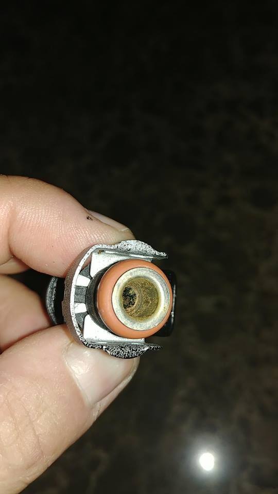

Straight out of the shipping box --- 496 injectors always need to be check out and service. NO BS these more times than not really need to be deep cleaned ---
tested and flow tested - --- so very common as they suffer from many contaminates - he is one of them. Straight out of the box - 2008 app not that many hours

would you say the contamination in that injector would be from the ethanol content in the fuel, and fuel /water contamination to turn it that yellow/brownish color?
if there was no water contamination i would suspect thet the ethanol would just leave white deposits correct ?

That set of 8 had rust thru out the cool fuel and alot of rust internally in the fuel rail. Water intrusion and it sat around for X AMOUNT of time. That was not from E 10 because the other engine was not like this period nor experienced the loss of 300 rpms. .
to further expand -- alot in the issues at hand cause injectors to end up contaminated internally all way thru the injector itself. .
Lack of maintenance
Lack of fuel maintenance
improper lay up for seasonal storage and or winterization.
water in the fuel and E 10 is NOT the main source of water intrusion
poor quality - some of these marine parts. ie: fuel rails , cool fuels, seals on top of the gas tanks, gas caps themselves, fuel lines, fuel pumps, fuel filters and so on.
496 injectors suffer from contamination -- so hard for them NOT to. I prob have 1000s of pics -- 496 injectors and most are in need of deep cleaning and flow testing beforehand.. Marine injectors suffer by far worse than ANY auto side injectors. BY FAR. - freaking junk yard auto injectors can be in better shape than alot of marine injectors sitting in owners garages.

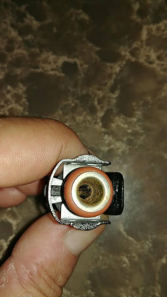

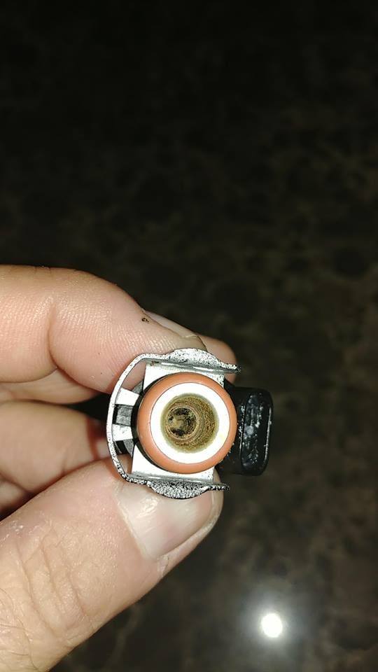

BUP can you test this type of injector? I dont believe they have a screen or do they?

YES I can. Any gas side injector I can test EXCEPT the Etec injectors. They require 50 Volts to do so and at steady state. But soon I will be able to test all Etec injectors. For those whom do not know etec that is Johnson and Evenrude outboards systems / engine and injectors.
I can TEST and clean all marine MPI and GDI and DI injectors for outboards, auto, truck, natural gas, jet ski, marine I/O and inboard. Even Merc Opti max - and Yamaha HPDI.
Also the 8.2 Mercruiser Cat engine and that requires special attention. Those injectors a person can really jack them up. And those are not cheap to buy period.
I do have alot to say about your injectors. for starters they become restricted flow in patterns and flow volumes.
VoodooRob as he has basically the same injectors. He knows what I had to do to make all that flow very very well again.
I will post more info about them. THANKS for asking as well.
