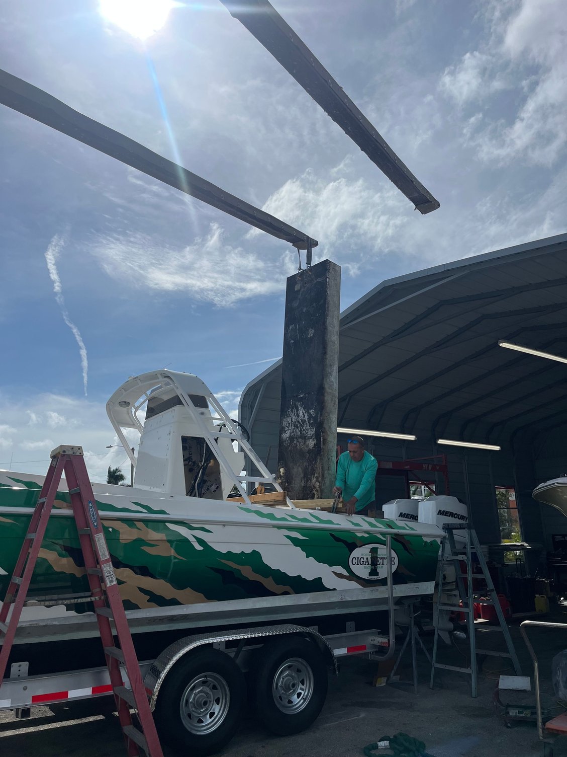

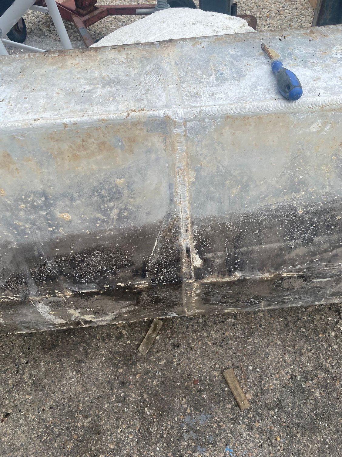

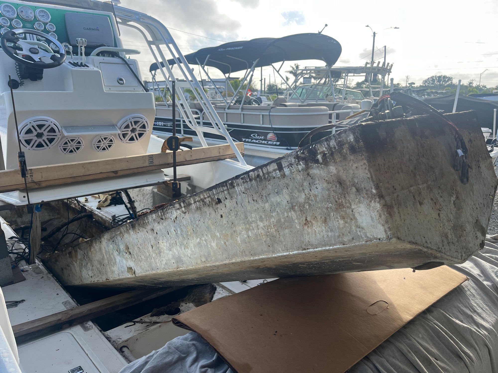

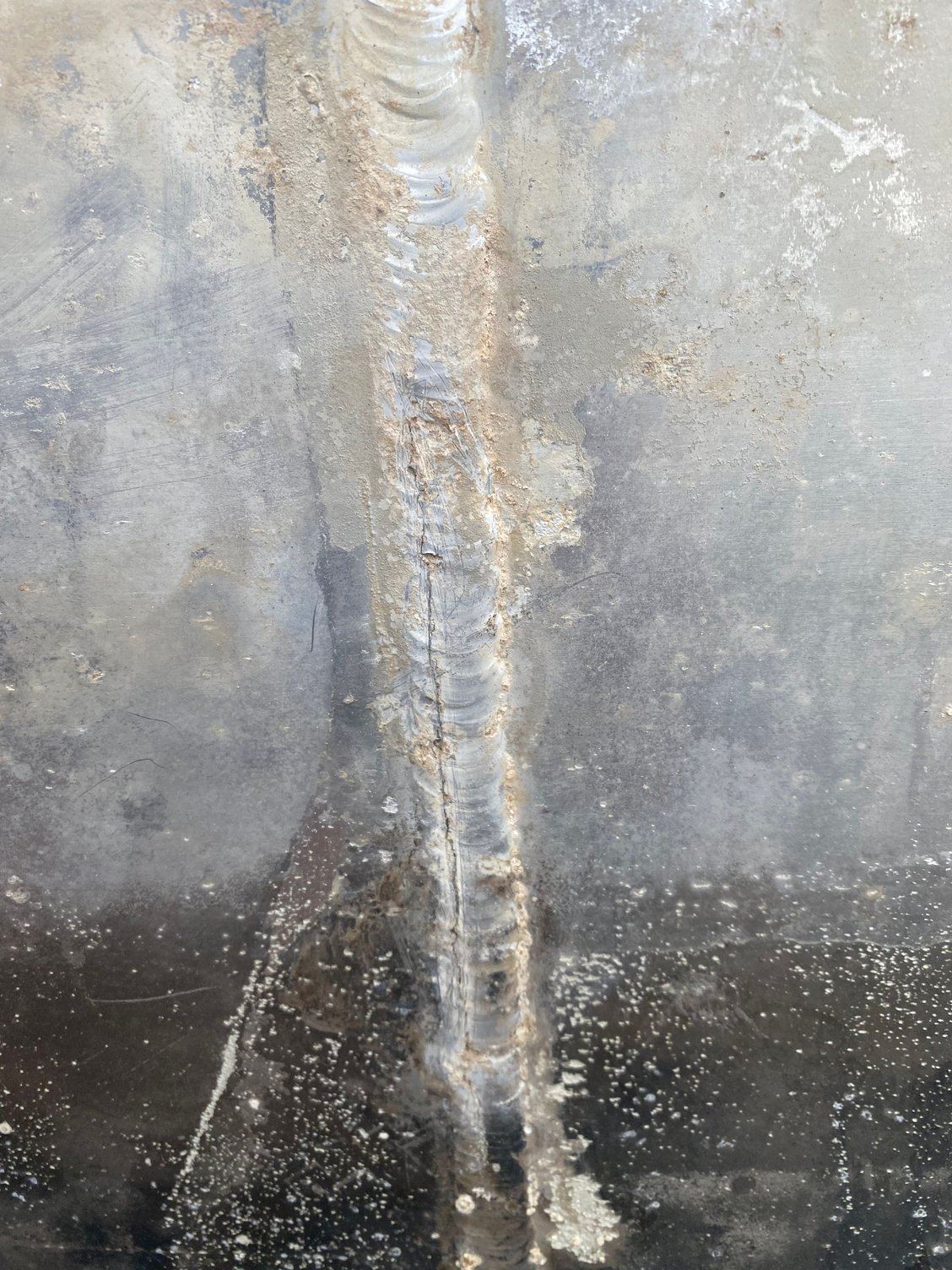

6 years later, here's an update! LMAO!!!
I'm posting this so maybe, just maybe it will help someone down the road. I've been a boat owner since 1983 and I have never seen anything like this. I will repeat, I never had fuel smell or fuel in my bilge, but constantly had water in my fuel tank. As it turns out, the tank was positioned in the belly of the boat in a compartment that had no drain into the bilge. I finally found someone who was willing to remove and replace the tank. Once it was pulled out, the reason was clear. There was a crack on one of the welds. I image that the tank was expanding and contracting with temp fluctuations and somehow it was sucking water into the tank. That's all I've got, the pictures don't lie! ;)

jeff32 11-14-2024 07:35 PM
crack was on the side of tank? or top i guess? If on top, not much water could stay there so you really had badluck to get water in there...
