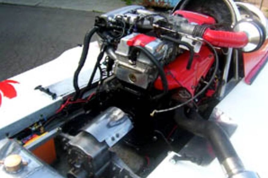

I know nothing about the conversion, but you should try if you can
2JZ-GE Hydroplane

Look up PSI Racing Eliminator Daytona. Really cool boat. Lots of vids on YouTube.

Search the boards here- there was an OSO member that marinized a couple of these motors.
