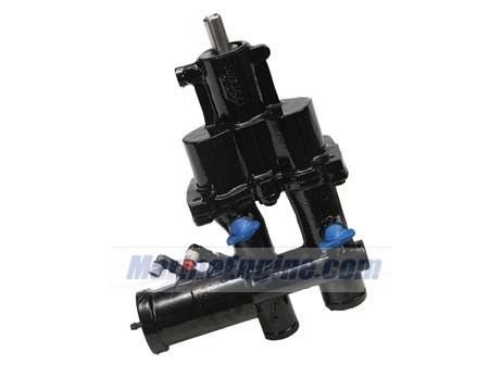

Bingo the discussion is SS to brass --- so AllDodge let me get this straight but first here is 2 pics of totally 100 percent brass pumps, These are 2 of the most installed pumps since 2001 thru 2016 for OEM Mercruiser that use blue plastic drain plugs .. So what you are telling me that one is better off installing SS plugs in all 100 percent brass pump rather than brass drain plugs or plastic drain plugs -- you got to be kidding correct - so what you are saying that 100 percent brass pumps promotes more corrosion because of dissimilar meters from in
stalling brass drain plugs into brass housing than SS drain plugs in brass - You can not be serious really ??

here is the other 100 percent brass pump with 2 blue drain plugs - the most installed pump from 2001 thru 2016 from OEM Mercruiser . The 496 as well, the cat engines as well anything with a bravo 2001 and up black side Mercruiser --- so again your saying SS drain plugs are better to install in brass pumps rather than brass drain plugs installed into brass or plastic installed into brass ? What I am talking about is SS into any other metals can promote dissimilar corrosion. You are not going to promote dissimilar metal corrosion Brass installed brass nor plastic installed into brass. So finally would you agree with this ???

I agree that SS and Brass have a minimal interaction and also this is not enough to cause a major issue. Issue is marginal and would take a very long time
