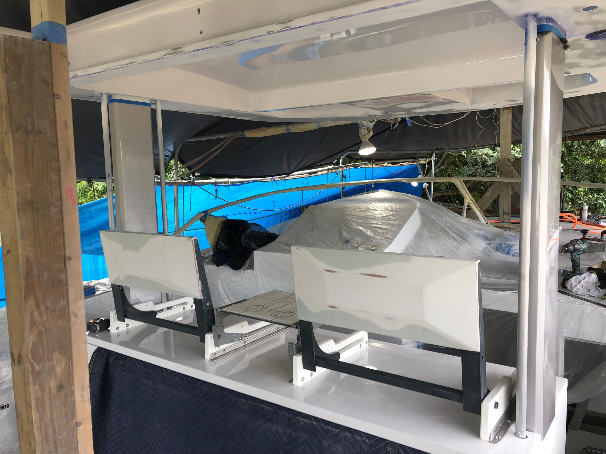

The foldable seats are on a board that goes up on hydraulics, underneath is a 6 foot long wide BBQ area with a 12x12 sink
https://cimg6.ibsrv.net/gimg/www.off...71f038792.jpeg
https://cimg1.ibsrv.net/gimg/www.off...ae59afd50.jpeg

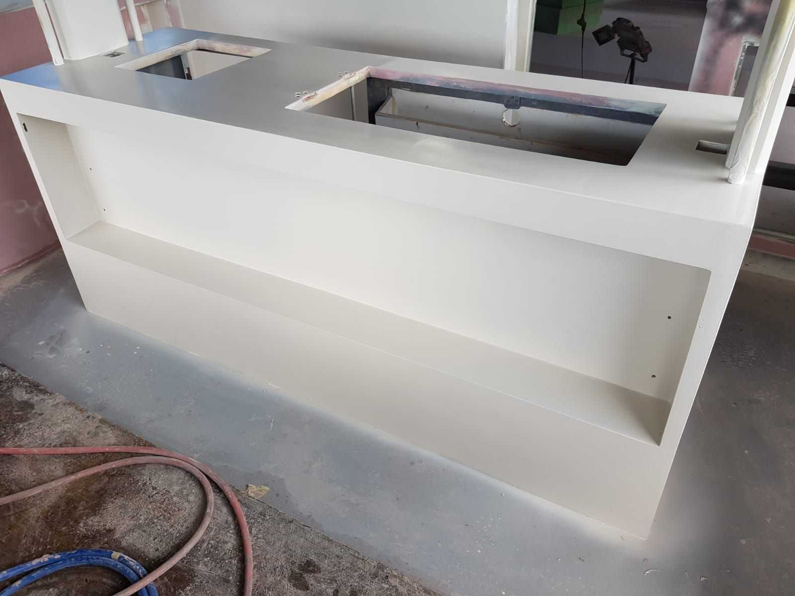

https://cimg8.ibsrv.net/gimg/www.off...aa30726f5.jpeg
The large cut out is for a bench ~6 foot bench seat that faces the forward facing seat at the end of the sunbed

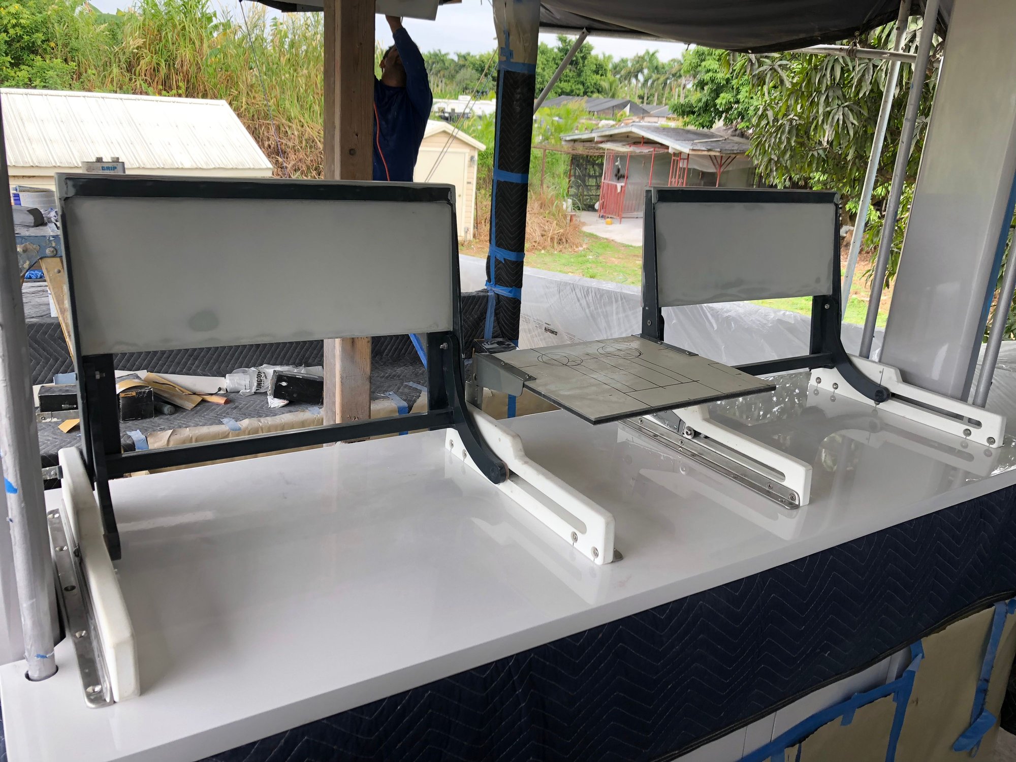

https://cimg9.ibsrv.net/gimg/www.off...dee7a49e2.jpeg
Grill is also on hydraulics

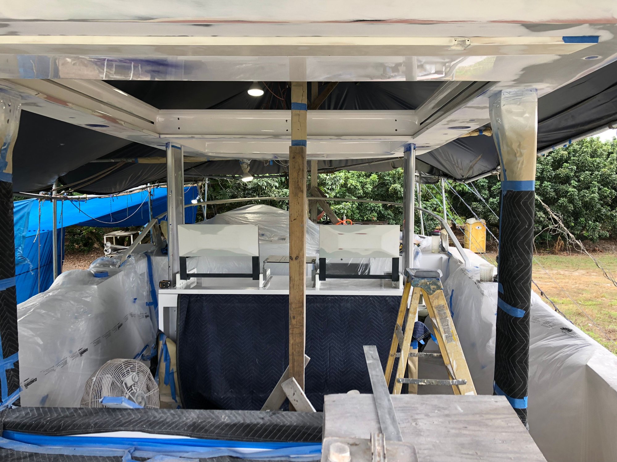

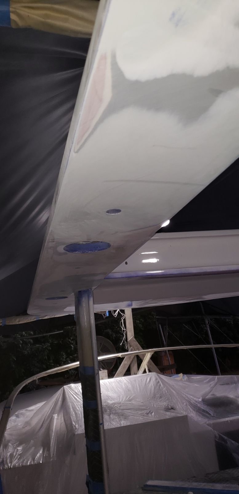

This weekend we Re-primed the edges and planes on the hardtop that we had straighted out last week, and started the final hand block sanding of these with 220 after spraying with blue pigment to find waves on the material. . Should be done with the hard top 220 sanding by tomorrow afternoon. Will go over with blue pigment again and 320 the following day.
Additionally, we Sanded the primer on the inside of the air intakes on the top deck
We also fabricated and faired a new piece that will sit vertically behind the helm seats to hide some of the exposed seat mechanisms. Will have to also make and polish four small plates to hold this piece in place.
Lastly we hollowed out the foam around the door locks on the hardtop rear hatch. This hatch will only be used to remove the “ragtop” when the fabric or poles needs to be replaced
Should get a gallon of pure white(no additional pigment) from Jon at quantum paints. I have been experimenting with white pearl flakes on awlgrip Snow White and looks pretty cool, should get better results over a pure white.

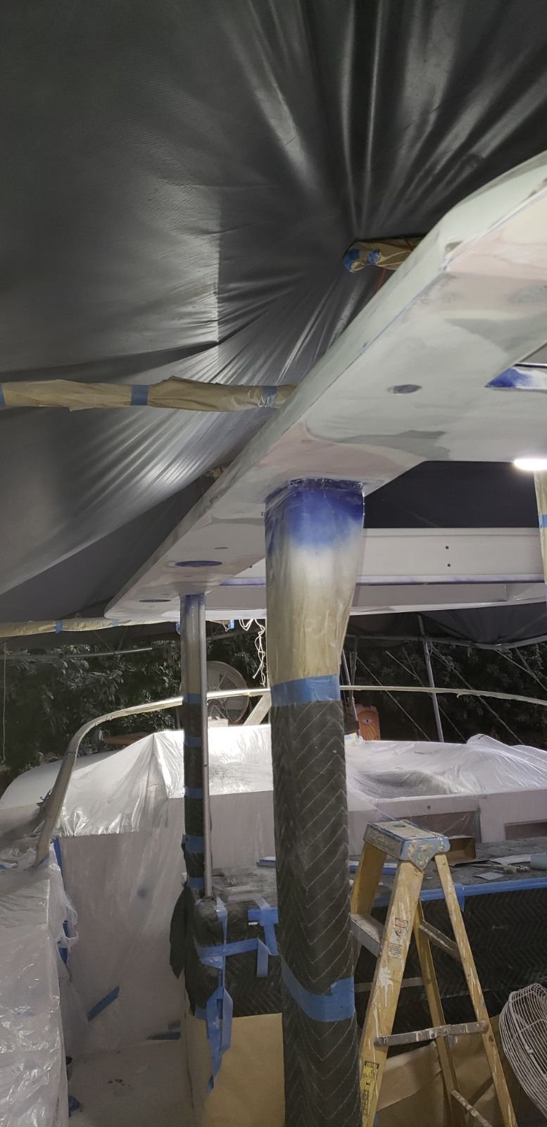

Before the primer
https://cimg4.ibsrv.net/gimg/www.off...1f2c4de71.jpeg
https://cimg5.ibsrv.net/gimg/www.off...a76d1380e.jpeg
https://cimg8.ibsrv.net/gimg/www.off...9cefdca0a.jpeg
