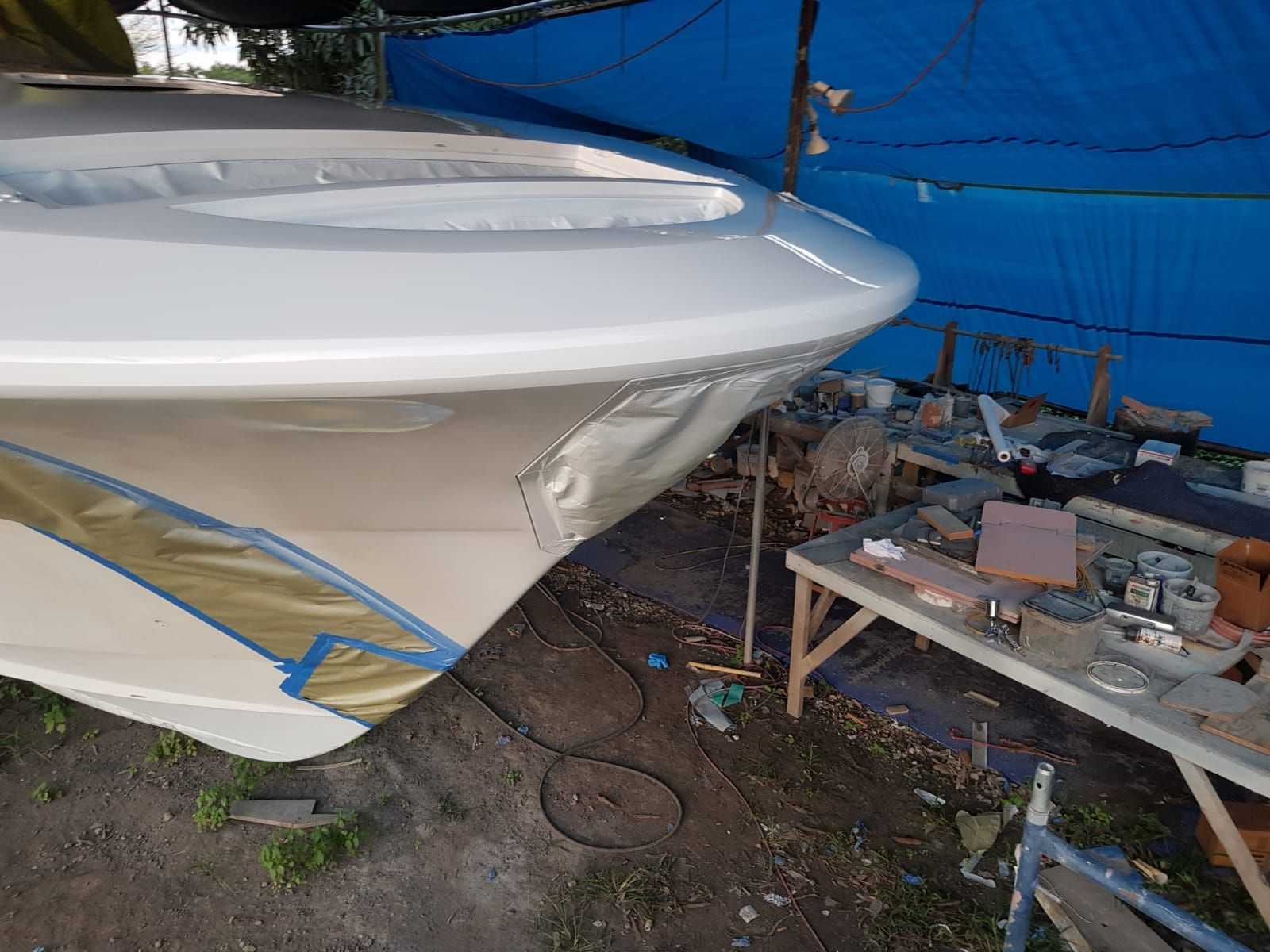

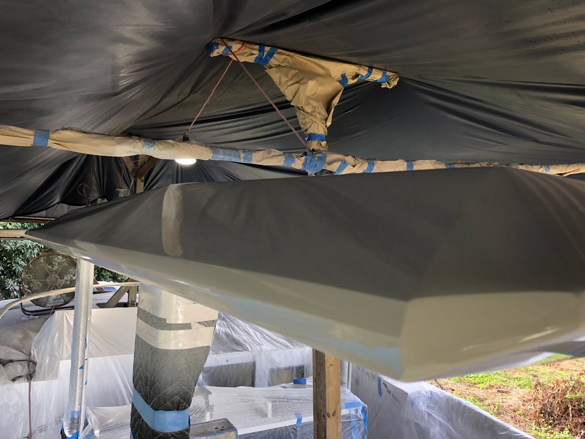

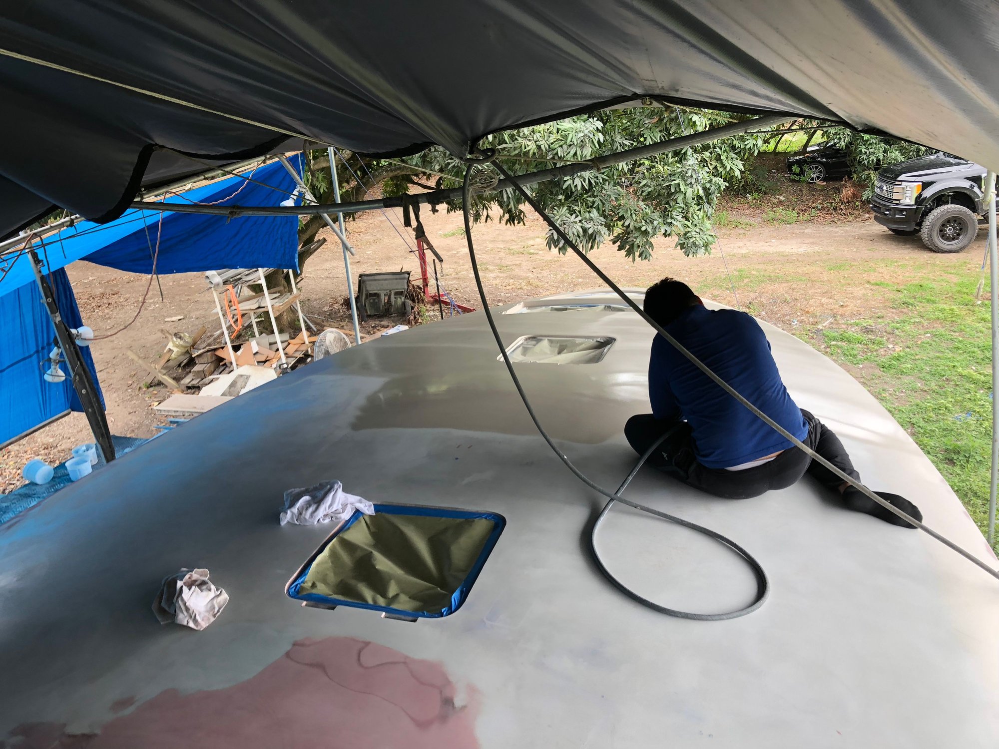

Thanks, it actually didn’t turn out so good, we didn’t get all the oil from the neumátic planner and we painted too late in the afternoon so it dried dull from the dew. we had to re-sand, and will paint again tomorrow. But it’s just a primer coat so can find any “waves”. For the final coats we will enclose the tarp. We are going to do a pearl on the deckand maybe silver on the hull

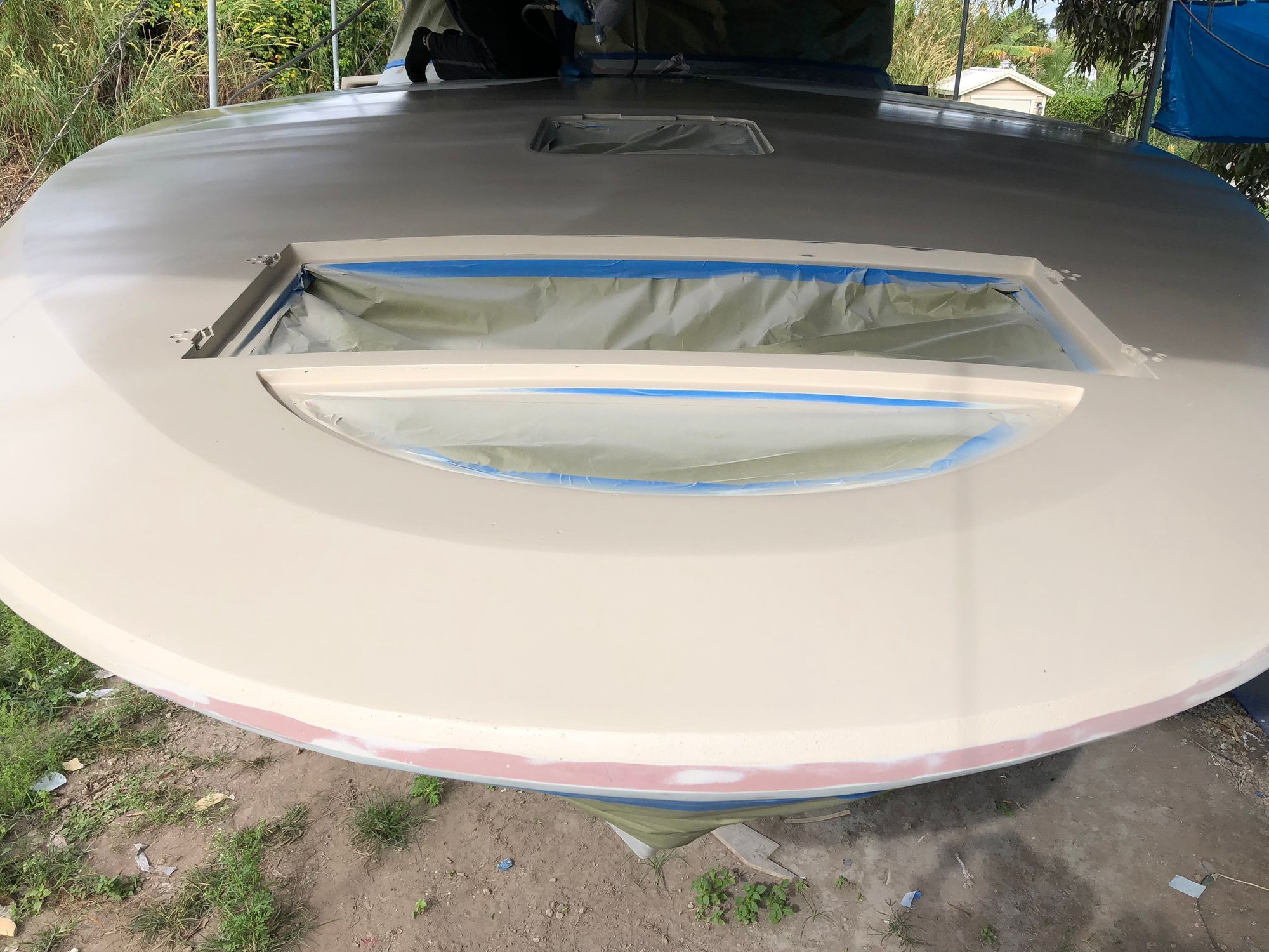

1design 12-19-2018 09:56 PM
Originally Posted by Wobble (Post 4664486)
Very cool project
https://cimg9.ibsrv.net/gimg/www.off...7e72012a1.jpeg

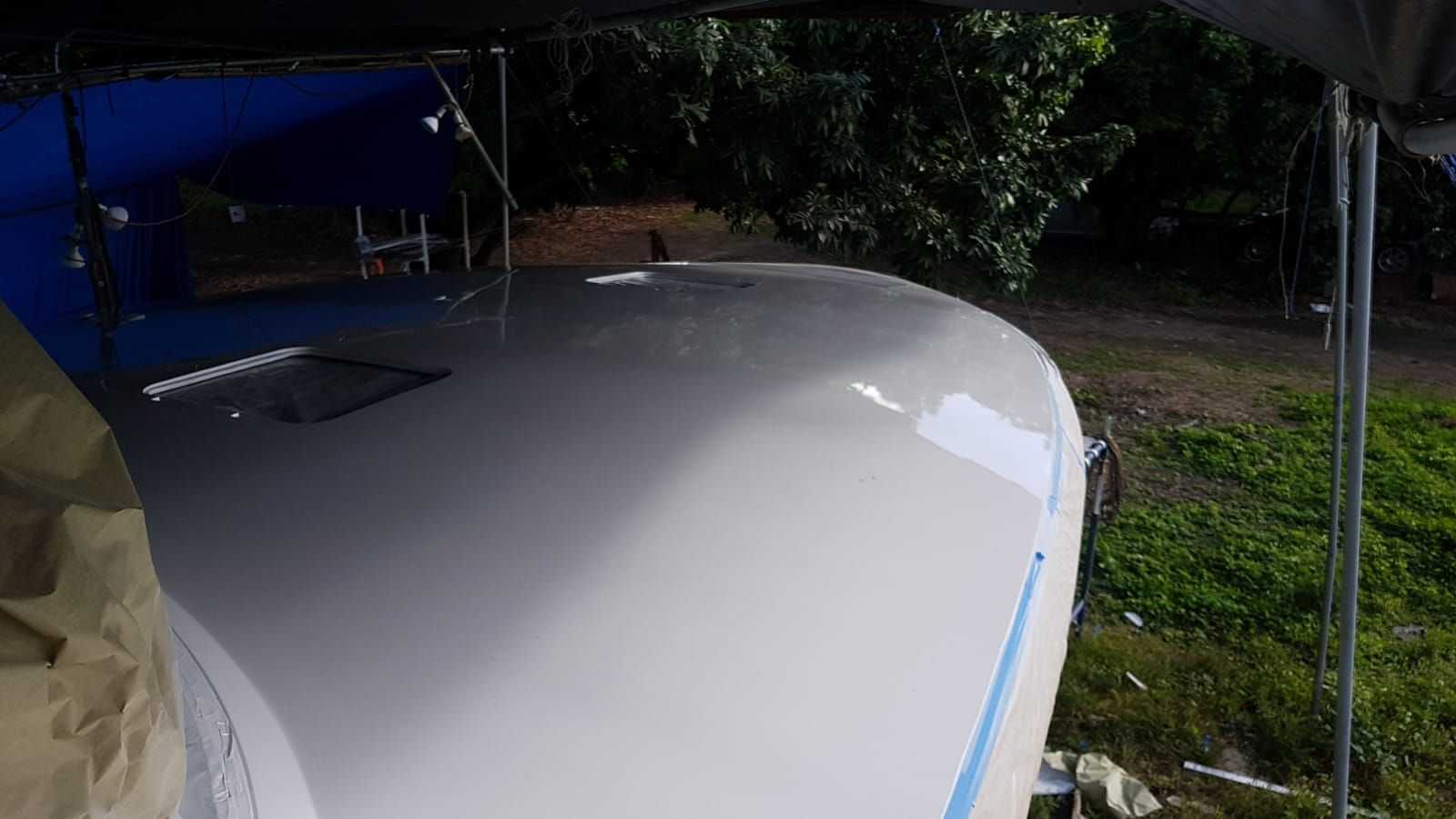

Finally got the paint(primer hand) on the deck. Off to the hull, and the start painting by early January!
https://cimg0.ibsrv.net/gimg/www.off...50b95b38f.jpeg
