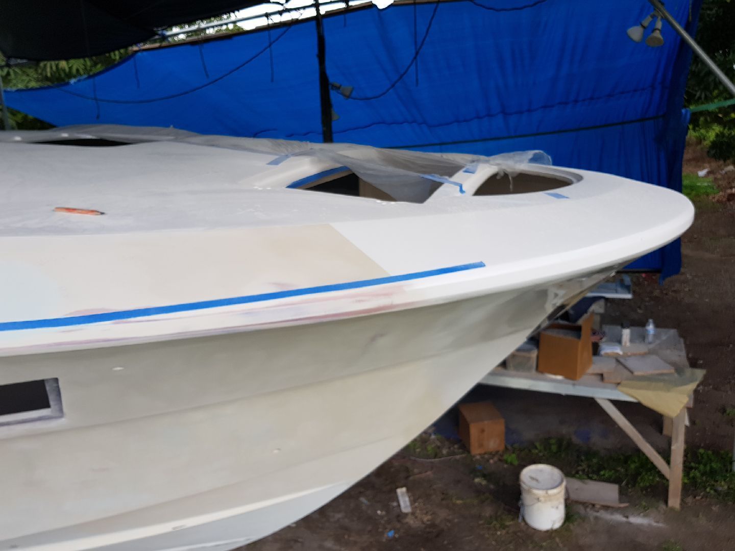

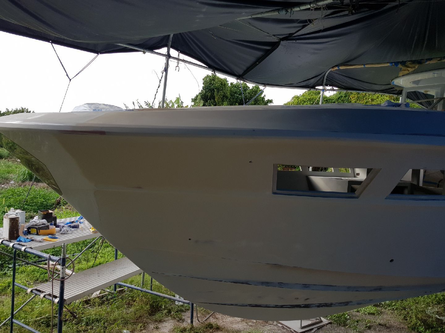

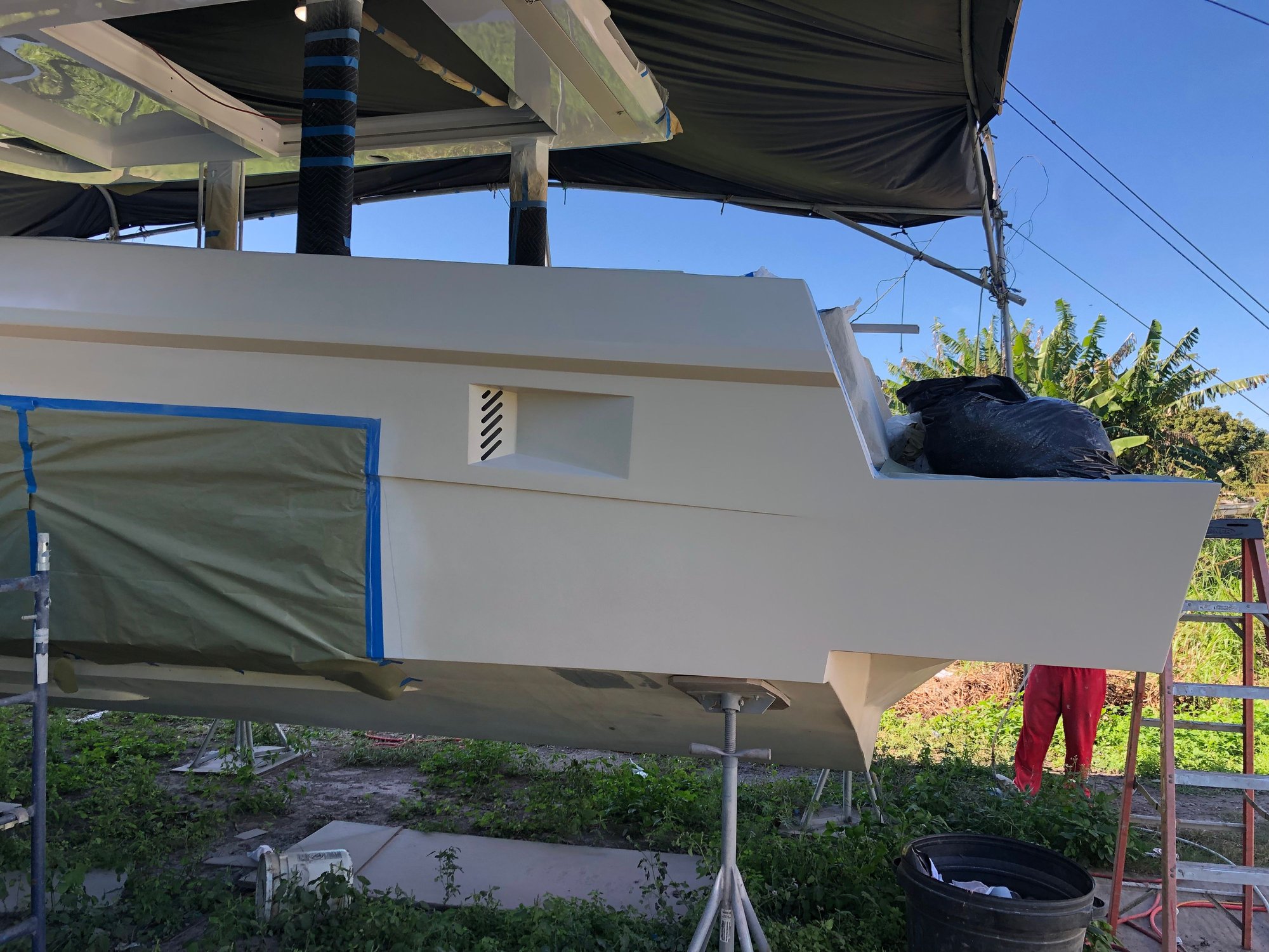

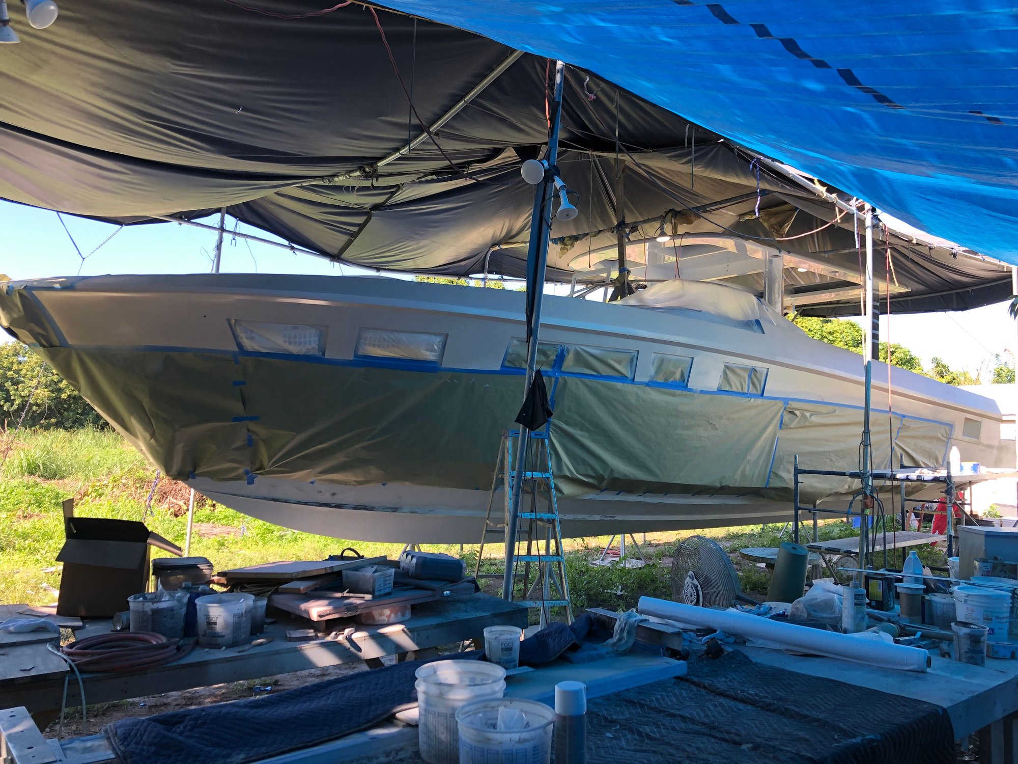

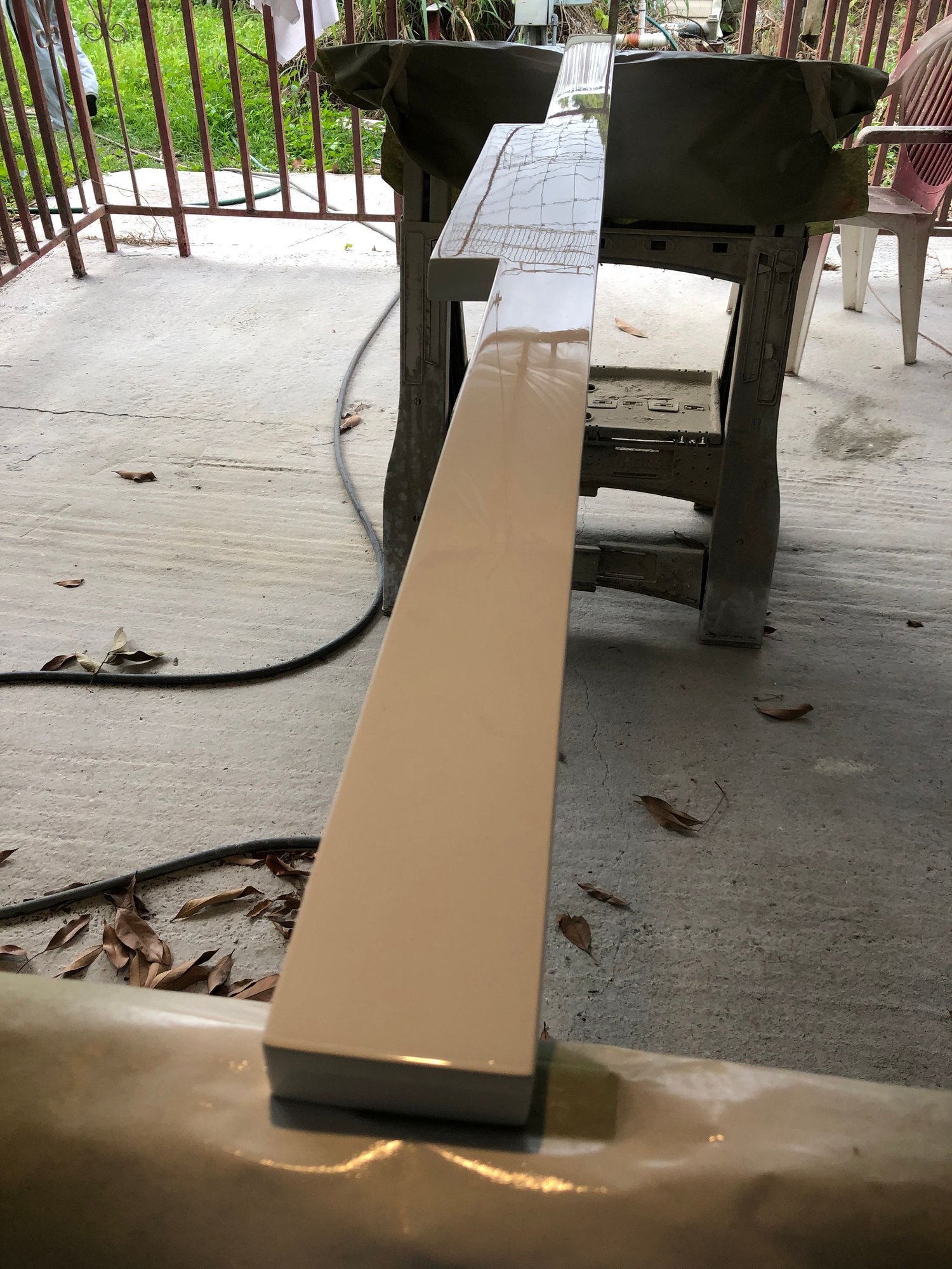

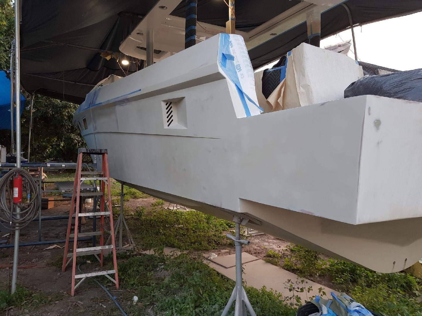

we have unwilling mastered the art of removing insects with X-acto blades. But these are just primer coats. Next month we will wrap the sides with plastic sheets and build an enclosure of sorts for top coat and clear.
For the smaller pieces we made a booth of sorts
https://cimg2.ibsrv.net/gimg/www.off...0e3ba20df.jpeg
Found some waves, that hopefully will go away with 320 & 400 grit before we apply the paint
https://cimg3.ibsrv.net/gimg/www.off...5cf7d7c9d.jpeg

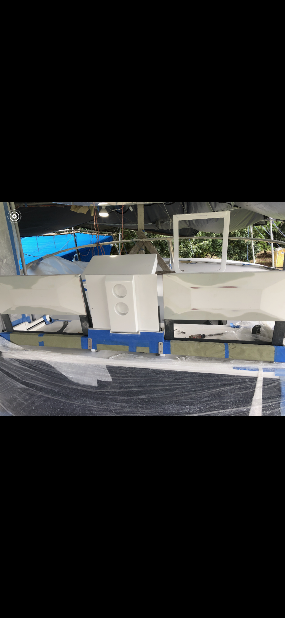

Flip down Center arm rest. The sides will get vinyl shaped like the center piece and the backside will become a small third seat when fliped up
https://cimg4.ibsrv.net/gimg/www.off...ac7aabb57.jpeg
1design 12-23-2018 07:37 PM

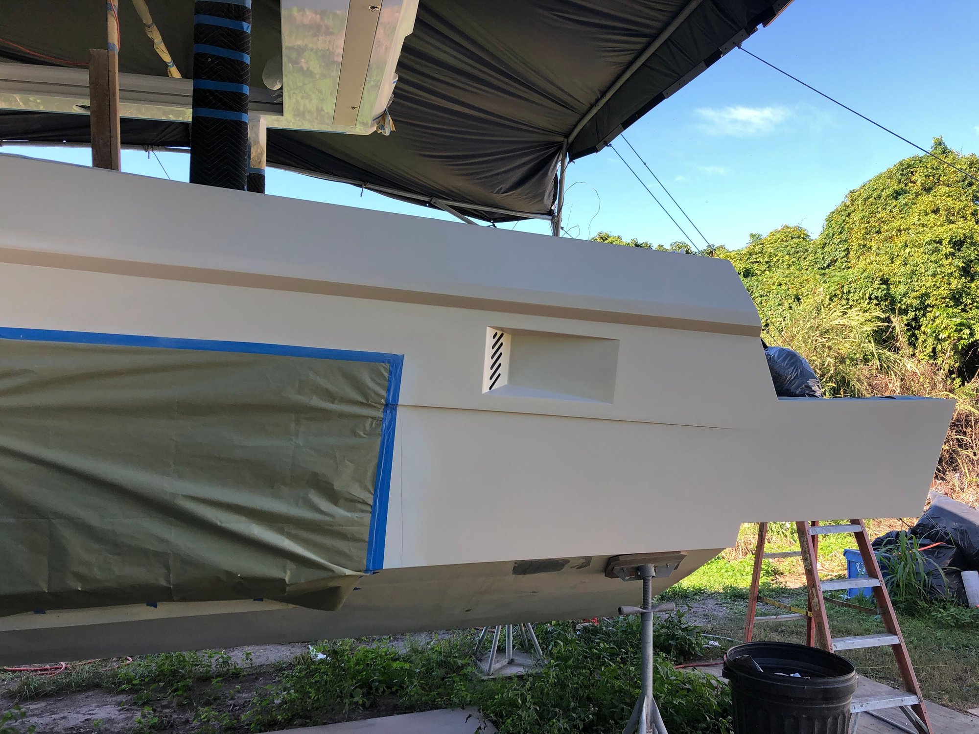

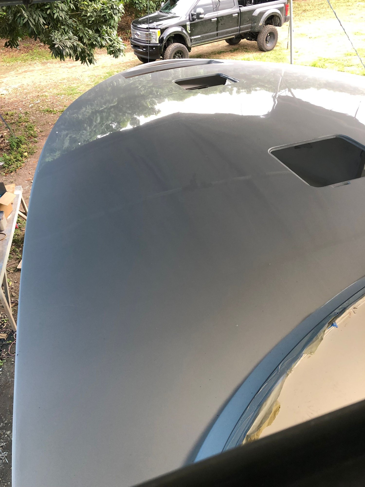

https://cimg8.ibsrv.net/gimg/www.off...020da6d2c.jpeg
Lines almost straight
https://cimg9.ibsrv.net/gimg/www.off...0e5232b31.jpeg
https://cimg0.ibsrv.net/gimg/www.off...eec14f59e.jpeg
https://cimg1.ibsrv.net/gimg/www.off...6255bc478.jpeg

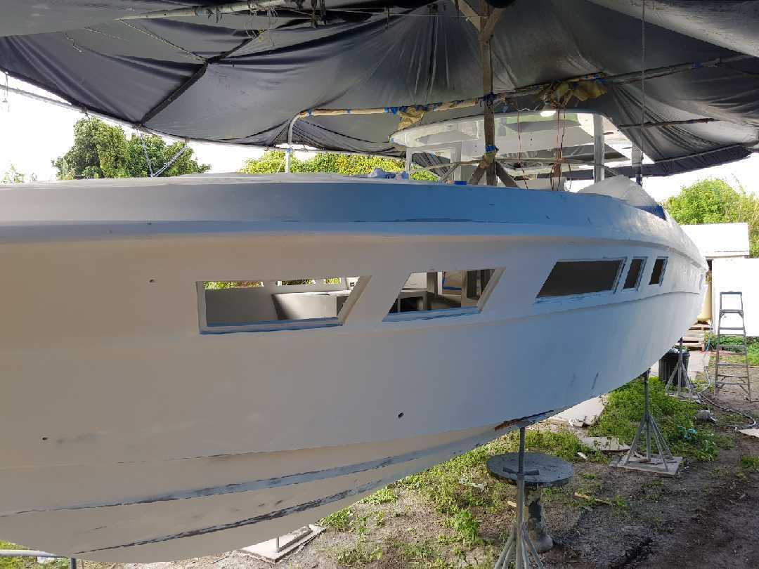

1design 12-27-2018 06:02 PM
1design 12-28-2018 09:09 PM

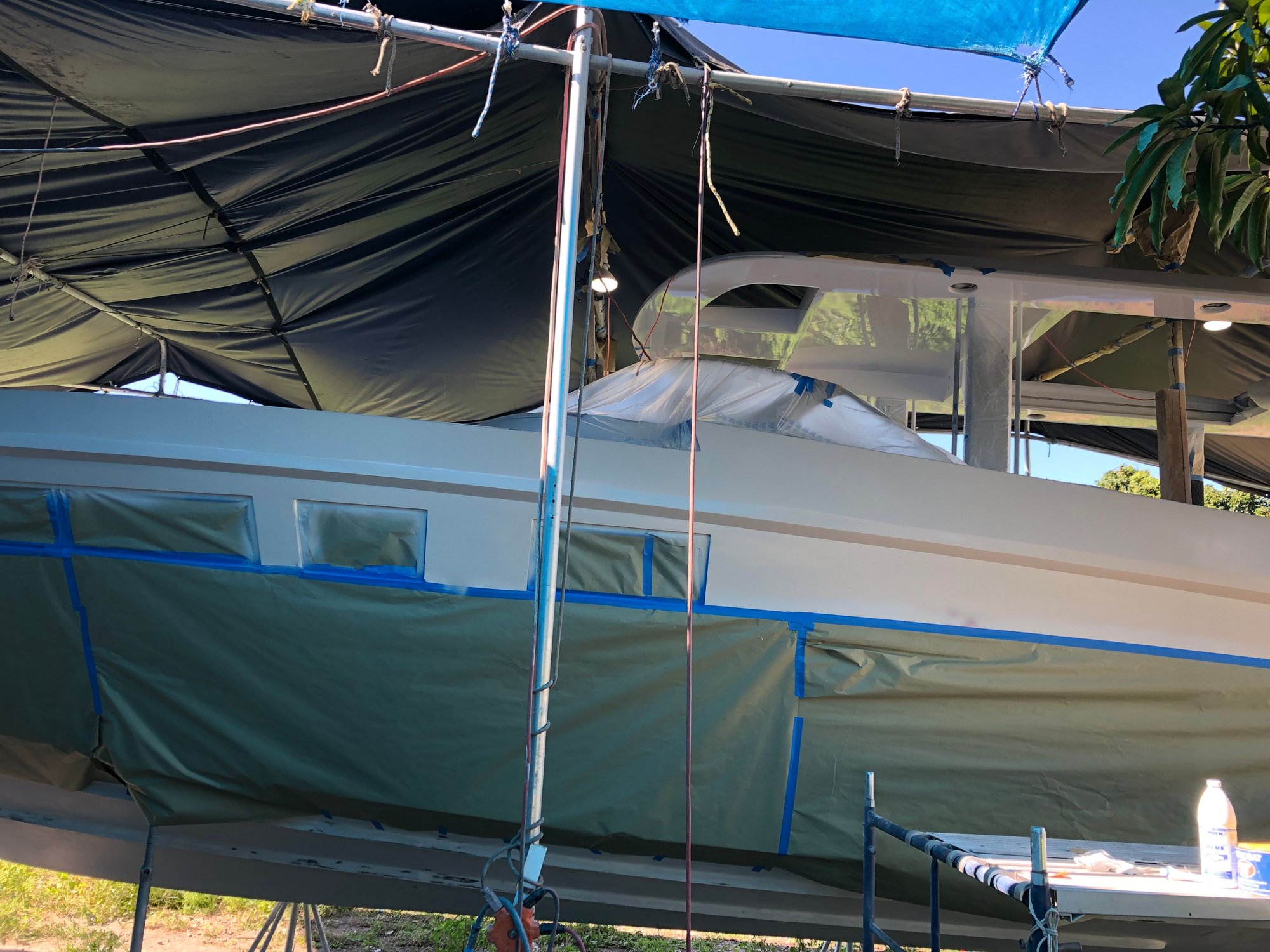

https://cimg0.ibsrv.net/gimg/www.off...3bdea121b.jpeghttps://cimg1.ibsrv.net/gimg/www.off...0904d48d6.jpeg
The original shape of where the cap meets the hull had more of a duck bill shape, so all of this area was built up with foam, glued in with epoxy and then glassed in.
https://cimg2.ibsrv.net/gimg/www.off...1c887b5f1.jpeg
