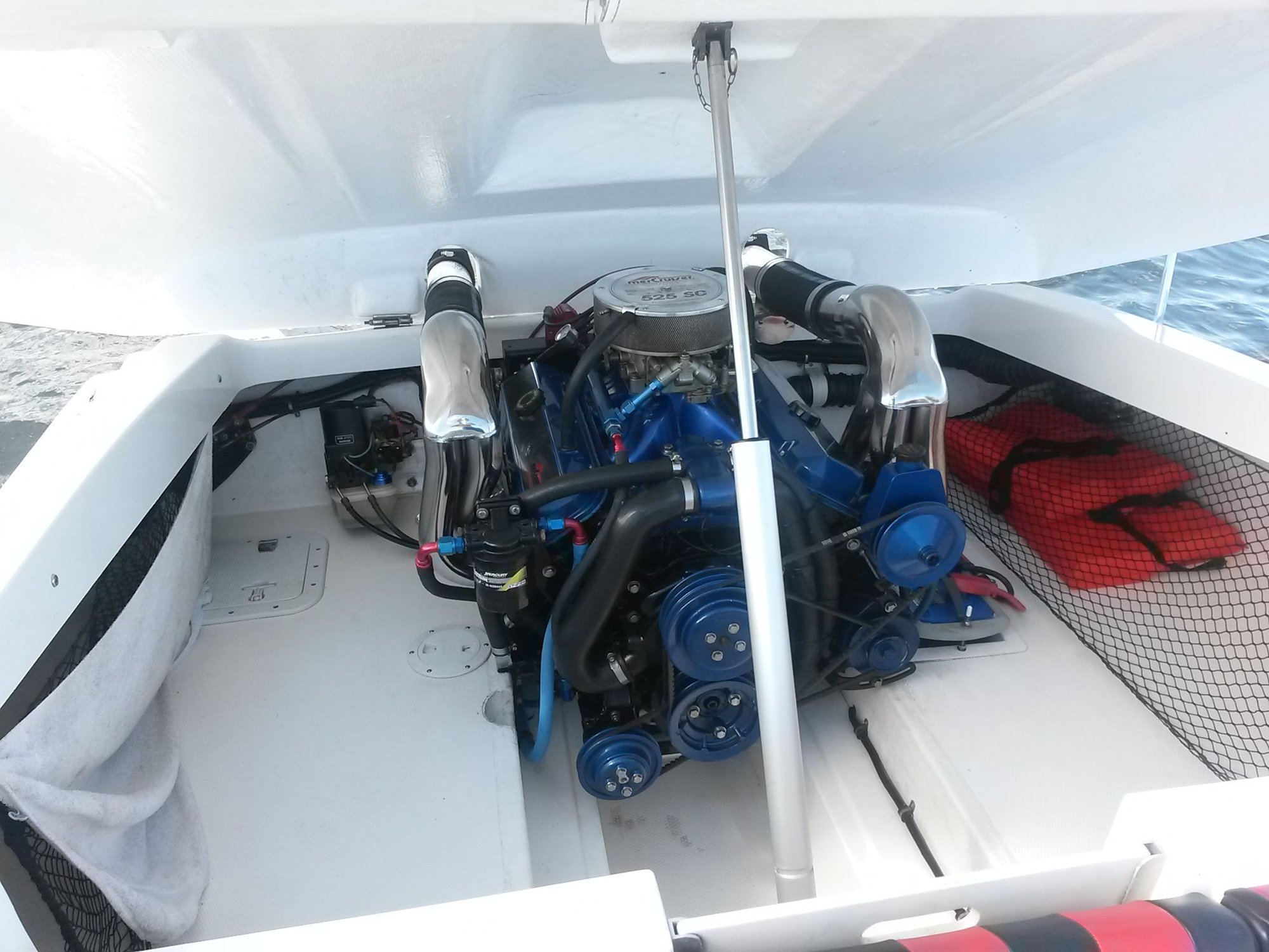

Same here would love to put closed cooling on my 572 in the Talon

That's a clean looking engine how many hours on it?...........salt water use only?........a full closed cooling system would extend the inside life by double!

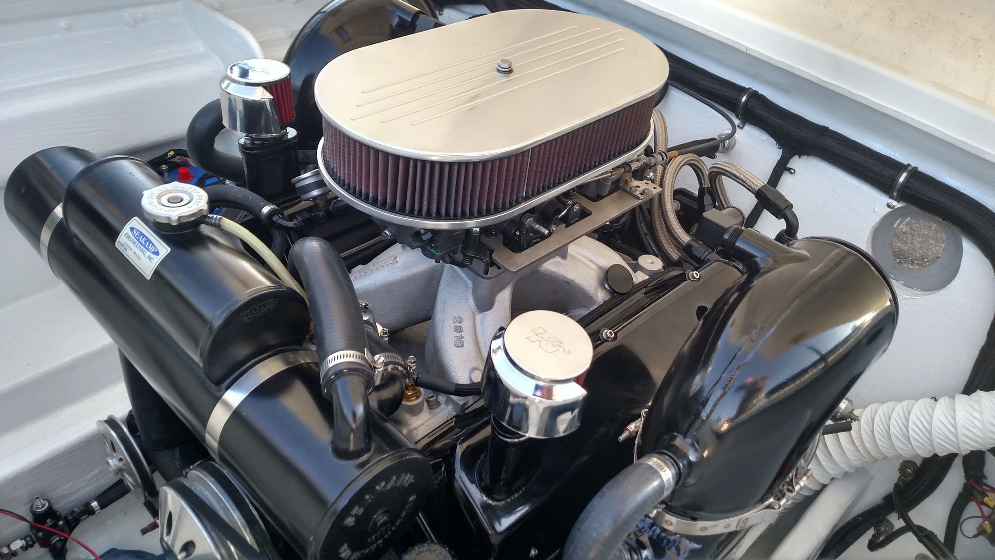

Here's a pic of mine....

598 tall deck...750 hp.... exchanger is for sale
