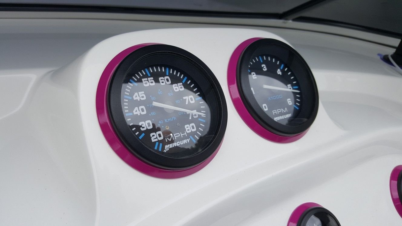

Currently I can turn Mirage+ 23 & 25P to near RPM limit on 496HO-MAG. Both props run 5200 according to tach so I think I'm at the limiter. That said need some feedback if I go to Bravo 24 or 26p Do the bravo's turn more or less when compared to the Mirages+? Also going to lab....
270 Convincor
thanks

With the 23 GPS showed 63-64 which is on when doing calculations. I didn't have GPS with the 25 but happy OEM speedomter showed 74 which I know isn't correct. So I calculate true speed of 68 using the same 5200. Photo is with the 25. I'm sure the tach is close but could be happy too by 100rpm.

That’s why I initially suggested a 24 Bravo..... but looking at his pics, if that 25 Mirage is stock, a 24 will be too short. If that tach is accurate, a 26 may be too short if he’s trying to get RPM down a bit (4600-5000 recommended).
