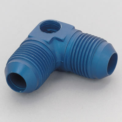

Here you go, replace the T with a 90,so even better,this way you can lose that cap.
https://www.summitracing.com/parts/a...2273/overview/
that is so Gucci that Prada is jealous. That is the way to go and just be done with it.
