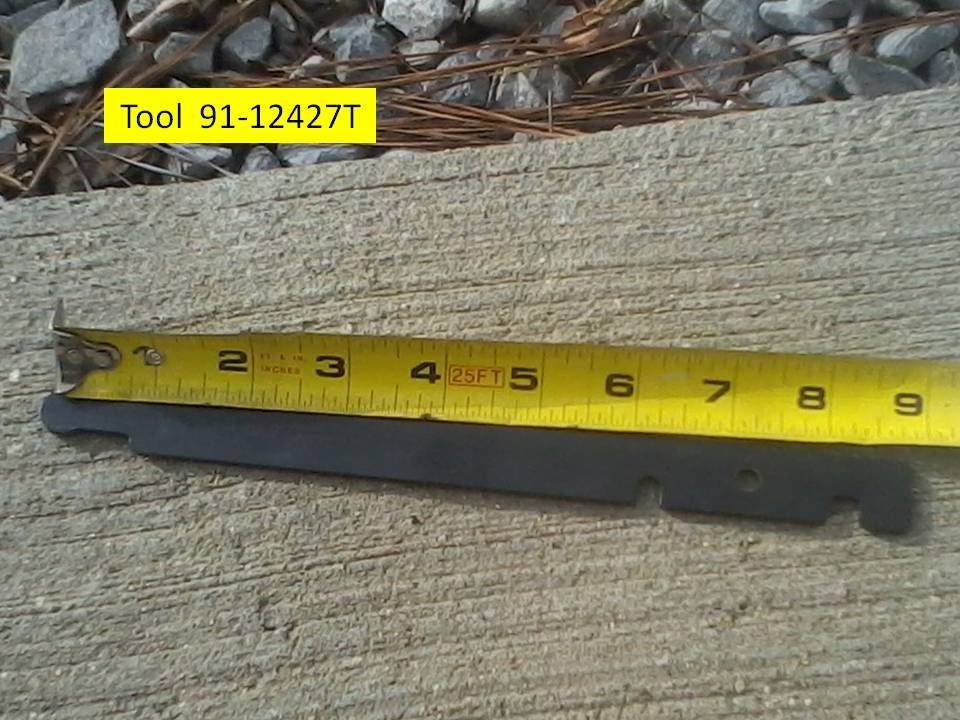

mercury has a little plastic deal that you can pull the shift cable from the linkage in the boat and use it to adjust. Sorry I don’t know the part number but may find something on google searching bravo shift adjustment tool or something to that effect.

I think your talking about 91-17262 which is used to set the lower shift cable position
Install as shown
I would see if there is still 3 inch spacing on shift cable, and if its there, then pull the drive and check if cable is still in position. If everything checks out, remove the rear cover from the upper and check out upper shift fork.

Thanks for the input but I don't think a shift adjustment tool will help me. The cable will shift into forward but is completely seized when trying to put in reverse. How do you jump across the slave relay to bump the starter?
