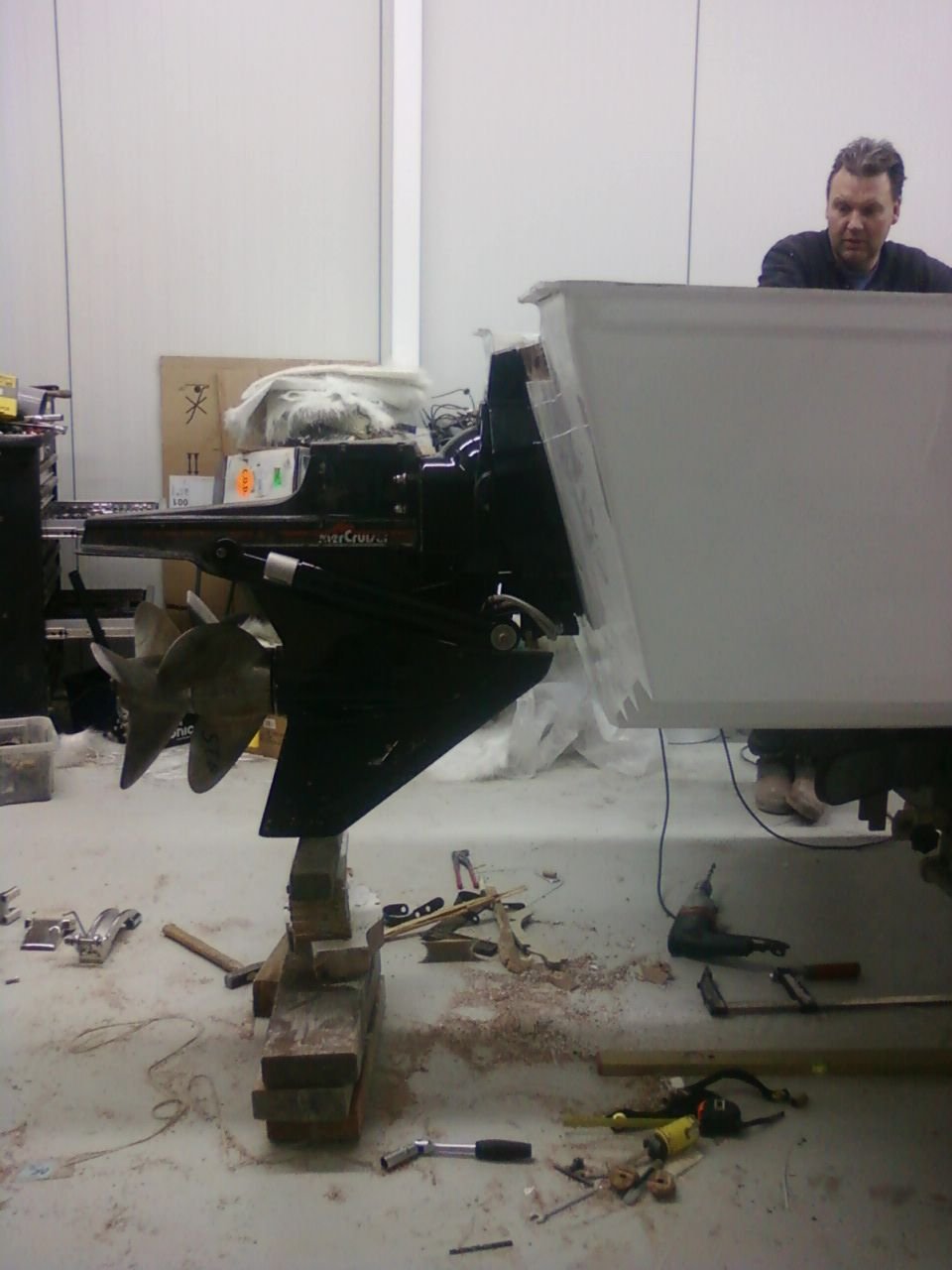

The blackhawk is really that short I had one one my 21 ft v hull whit stock bravo it was 6” below and whit the Blackhawk it was 2” above
keep in mind your boat have to have natural bow lift (rocker ) In the bottom because the drive is a full surface drive and don’t provide bow lift .
Parts are all Bravo one in upper and bravo 3 on lower except the vertical shaft but max machine worx can supply them and even convert to xr internals
I ended up whit a imco -3” that had same performance and handling but provided more bow lift that my hull needed
hope this helps
