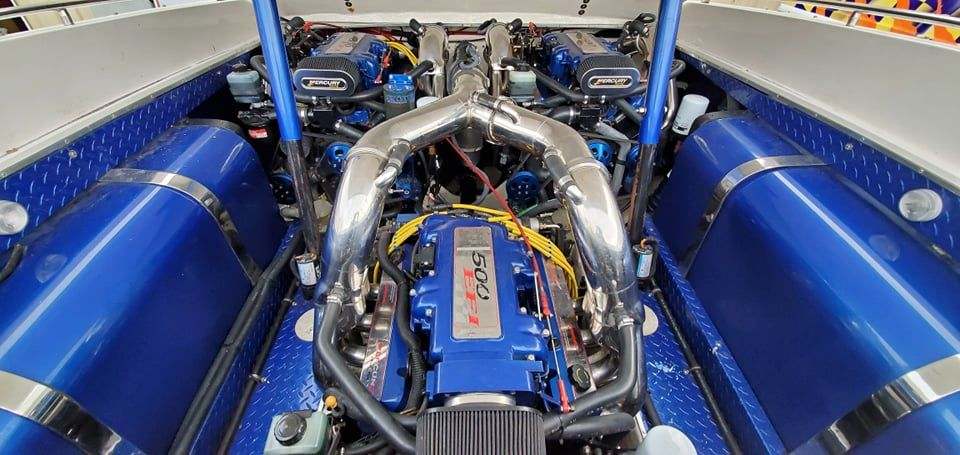

WELL... It's time once again to replace the header gaskets and I'd really like to find a gasket that will last a full season of boating. Any suggestions, as you can imagine it's quite an ordeal with triples.
