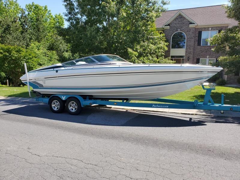

Did you spend any money addressing all the fibreglass issues you mentioned in your thread 2 years ago? Were you able to try a Mirage 21p? If you haven't spent any significant money the last two years, then I would sell her. Boat looks good and sits on a nice trailer. At this time of the year you might get $5k-$8k for her. There's plenty of $20k-$25k great condition boats for sale now that are a few feet longer than yours and will run in the 60s and 70s. Here's just one example that probably might be had in the low $20k range soon.
https://www.powerboatlistings.com/view/65281
