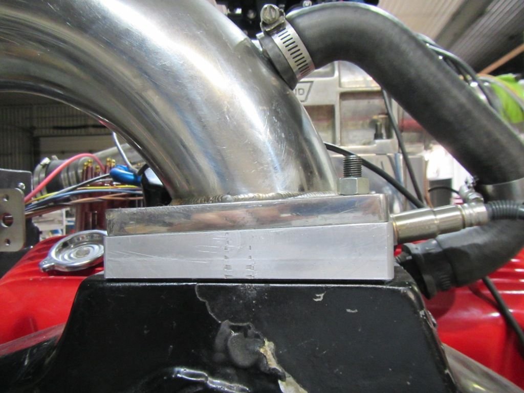

resurrected 09-02-2020 06:04 AM
I wasn't confident in welding bungs in my risers so I made spacers
https://cimg4.ibsrv.net/gimg/www.off...55188fd2de.jpg
