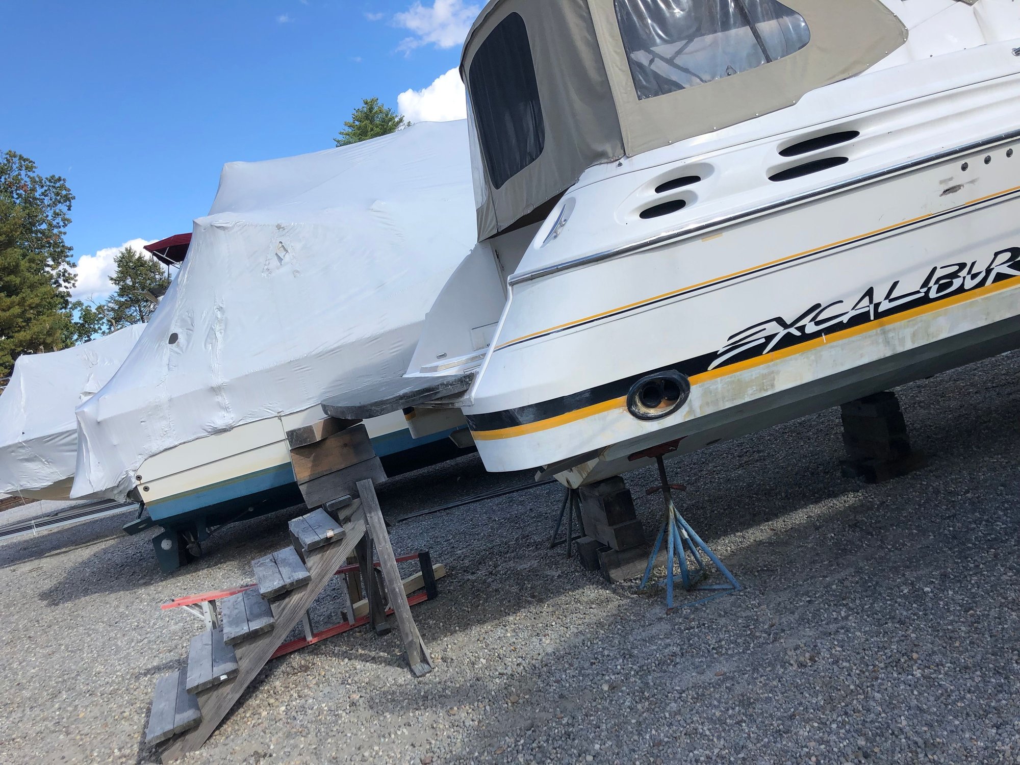

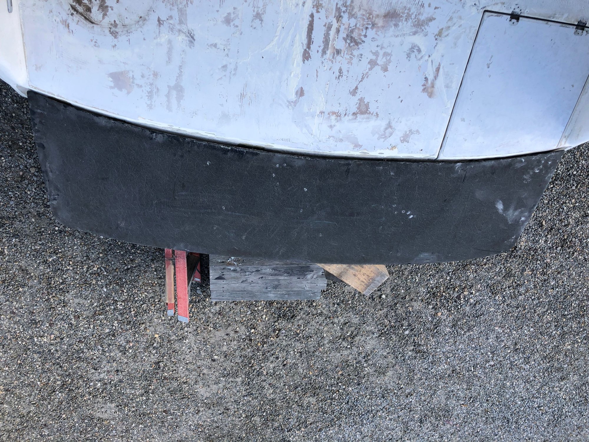

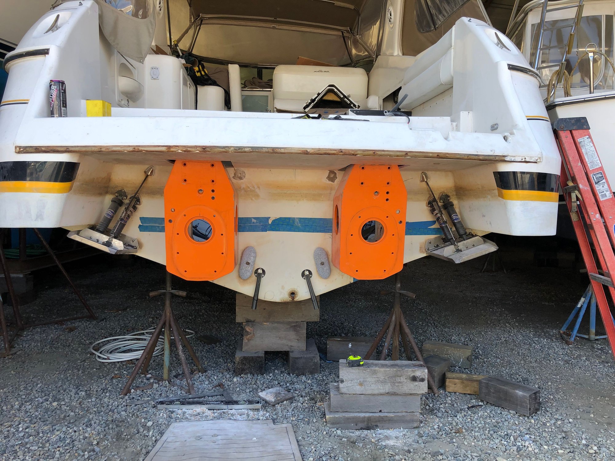

Hi Matt
Just started back working on it, got sidetracked this summer working on our 41 Apache.
Holes are cut in transom,
Laminated coosa (airtex) with epoxy resin super strong
extension boxes mocked up then pulled off and sent to powder coat(black). Built a swim platform extension to prevent someone jumping on props. Got it partially attached need to do some more glass and gel to finish. Props in production....looks like I’ll have it ready for next season.
