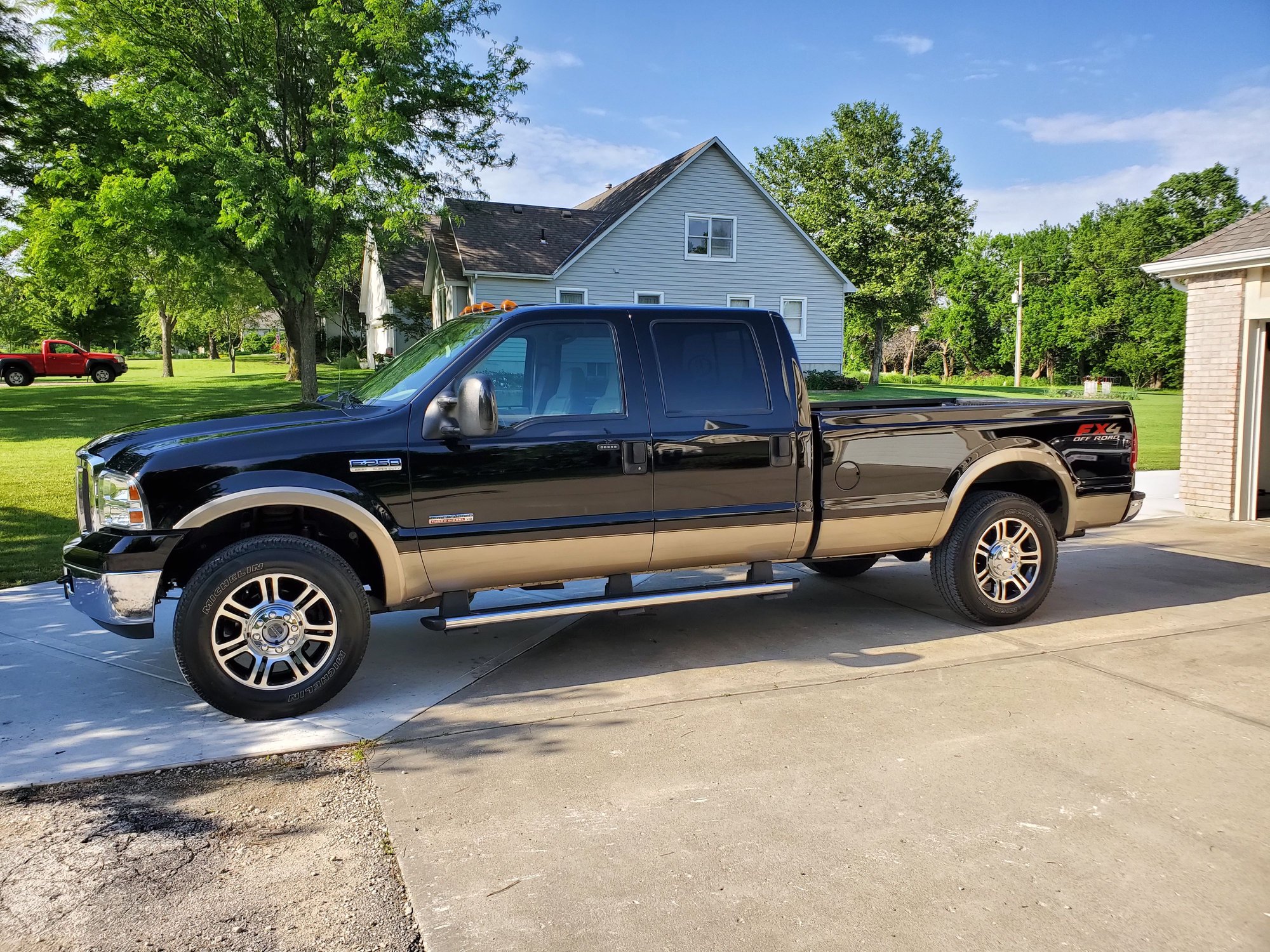

Me............2005 with 82k on the clock
