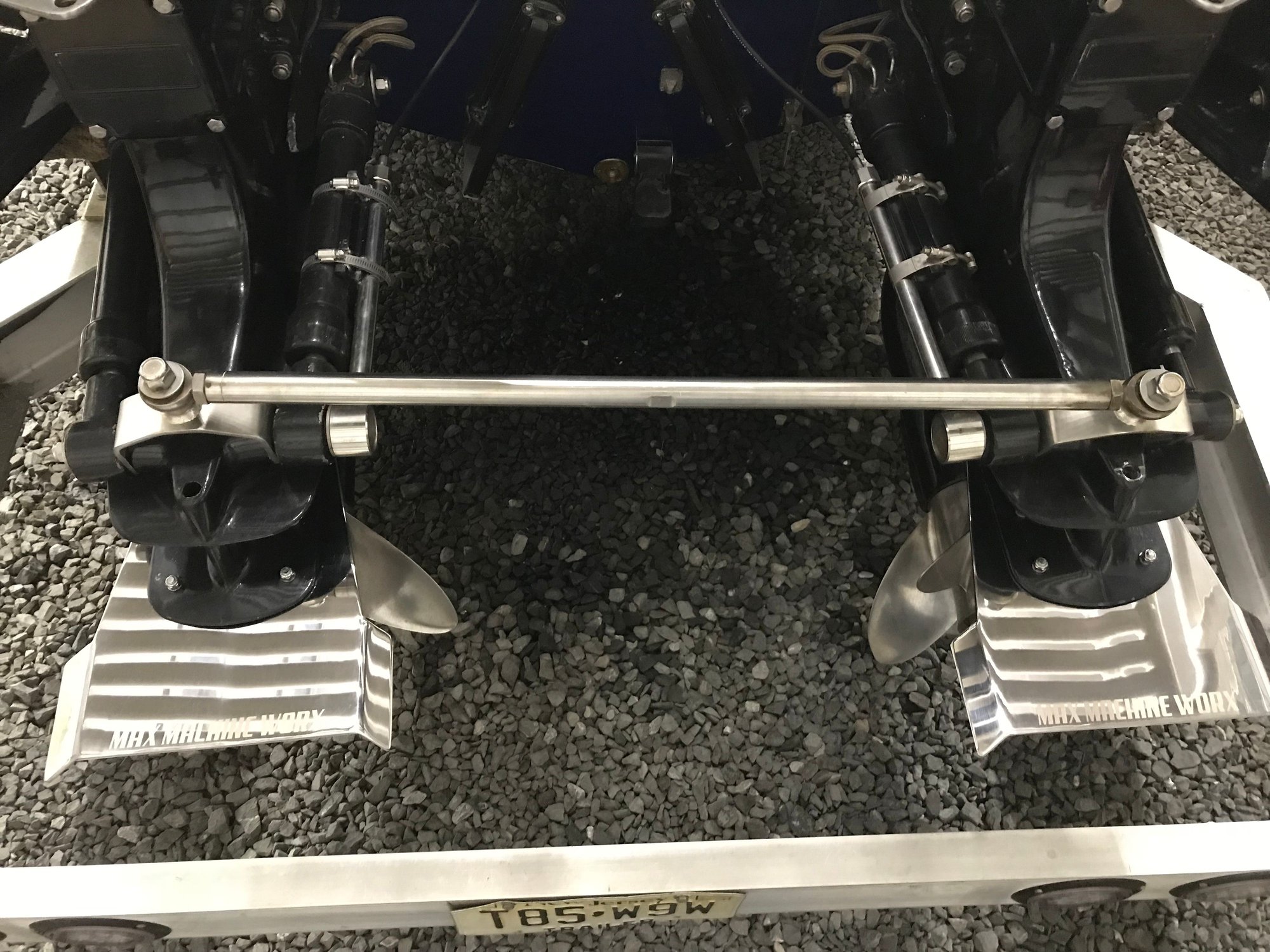

Craney 05-08-2021 07:29 PM
I got my cavitation plates on can’t wait to try them to see if any difference. I would think they would work on a #3 drive I have them on Trs drives.
https://cimg8.ibsrv.net/gimg/www.off...74d4a2db5.jpeg
thisistank 05-08-2021 07:32 PM
Nice!!! Can’t wait to hear how it goes!
