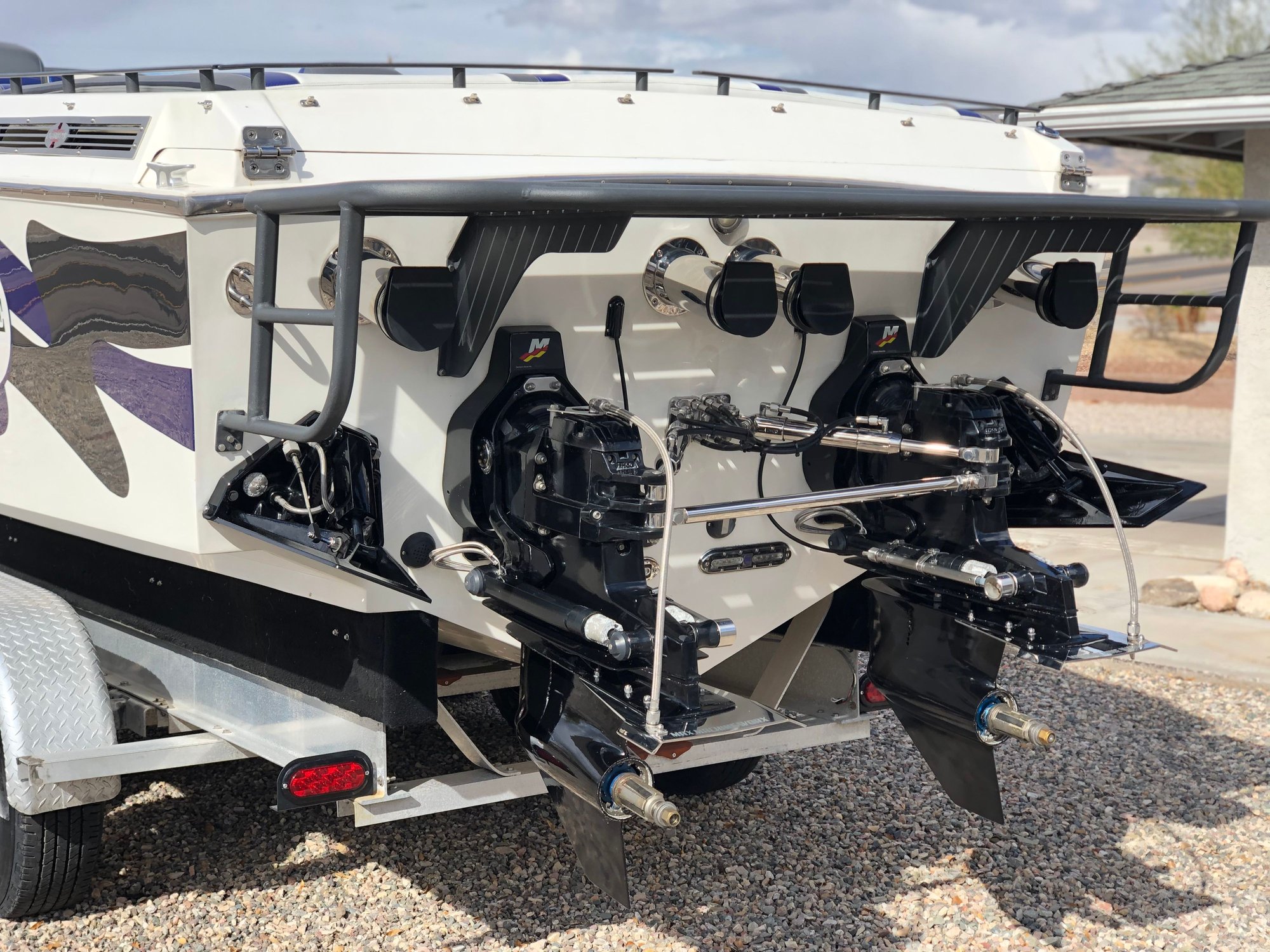

Tank how far back is your cavitation plates mounted on your drives?

Here’s a few pics. I don’t know exactly but looks like a couple inches. I can get more pics or a measurement next weekend if you need.

Thank you the first picture is good that is all I need again Thank you. I hope they work as good for me as they did for you.

They really work fantastic on the cafe. Night and day difference. Lotta bang for the buck.

You have probably said somewhere, but exactly how do they help? Better ride? Faster time to plane? they look great!

D. All of the above.
I dont need to use any tab to plane. Don’t need to run the boat with any tab at all. Kick the drives out a bit and run it. Zero porpoise. Stays on plane easier at low speed as well. Things are pretty awesome.
