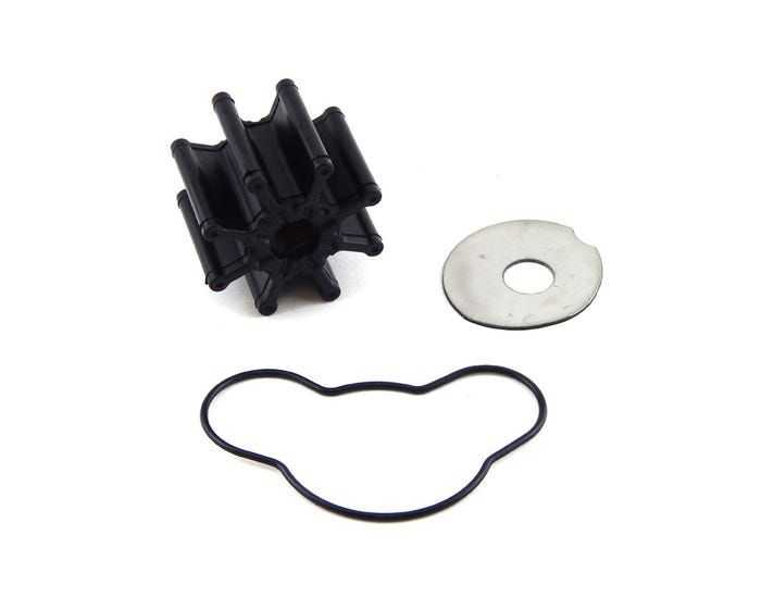

After not finding anything definitive last night, about gave up and thus figured start this thread, I started another search and just found this - and factory parts !
Mercury-Mercruiser 47-8M0137219 Heavy Duty Sea Water Pump Impeller Kit
Mercury Marine 47-8M0137219 Impeller Kit.
Features:
Number of Blades: 8
Impeller Diameter: 2-5/8"
Impeller Length: 2"
INCLUDES:
(1) - 8M2021987 - Formed O-Ring
(1) - 8M0103389 - 0.030 in. Shorter heavy Duty Impeller
(1) - 8M0072979 - "Overmolded" Inner Wear Plate
Mercury Quicksilver OEM Water Pump Impeller Wear Plate 47-8M0137219 47-8m0120891
Quicksilver 47-8M0137219 Heavy Duty Seawater Pump Impeller KitIncludes shorter heavy duty impeller and over molded inner (front) wear plate for use when the front of the seawater pump impeller housing is worn due to debris.
Fits 2000 & newer MCM V-6 & V-8 (305, 350, 496 & 502 cid) engines with the brass sea water pump excluding Mercury 4.5L & 6.2L models.

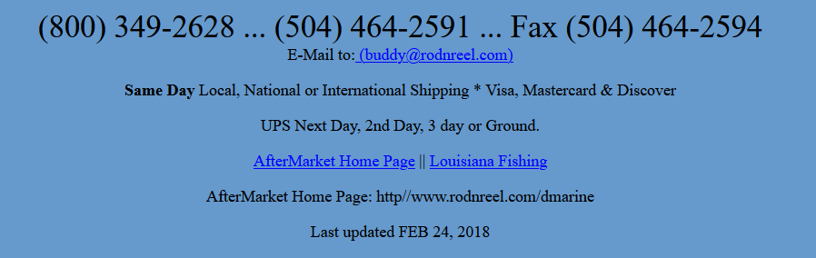

Originally Posted by BIGSLOW
Been trying to get a hold of these guys for weeks. Voicemails and emails with nothing in return. I gave up.
I hit the Louisiana fishing link shown below at the website and at that page get the second snip. Same guy??
The repair kit website has a bunch of dead links and missing photos. Seems poorly maintained.
