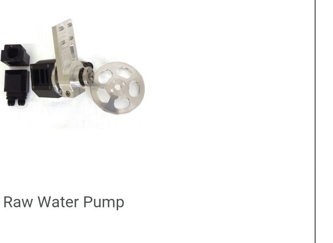

If its this pump in the pic and the housing and shaft are good you can rebuild the pump with new bearings and seals. I ran these pumps on my skater and i use to rebuild them when the bearings went bad. Bearing #6204RS Seal# 20.32.8 you can get them from Buffalo Bearing. If the housing is cracked or beat up you can get the new housing its a new design i ordered one awhile back.
that's the pump. It sucked something in and there is plastic melted onto grey housing. Doesn't really want to come off and I know I'll gouge it up pretty good if I can remove it at all. I was looking to replace just the pump body.

Did you call peterson? They sell the parts for Keith 512-296-3434 Last time i bought the housing it comes with the new shaft because its a new design.
