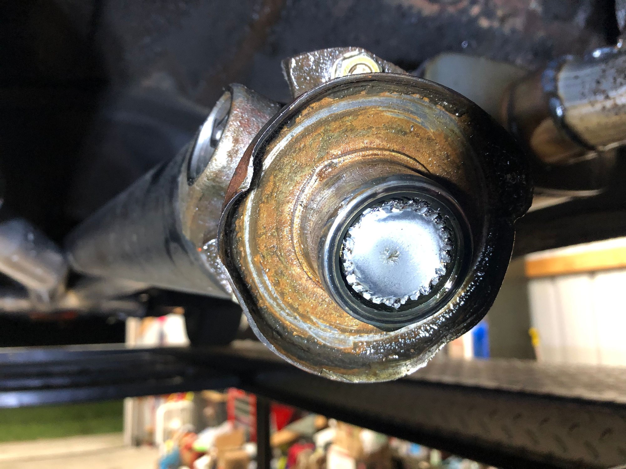

Light car or not, a stock 8.5” might hold up to ~600hp, but an 8.2 won’t. Mine came apart in a 3700lb car w/500hp and I’m really lucky I didn’t lunch the quarterpanels, as the c-clips were in the bottom of the pumpkin on disassembly. Twisted the pinion in half and put a chicane in the trans yoke, too. The new Moser 12 Bolt has 33 spline bolt in axles, 1350 yoke, etc. Way more better.
https://cimg6.ibsrv.net/gimg/www.off...a7a700723.jpeg

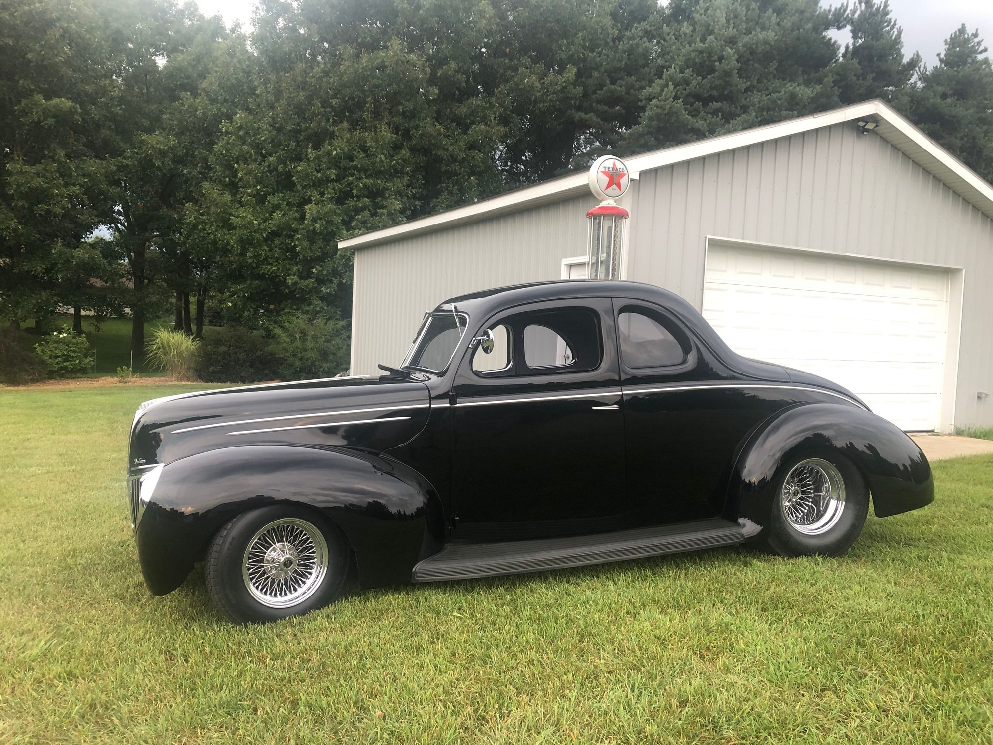

My ‘39 five window sits atop a TCI (Total Cost Involved) frame with Mustang II front suspension and parallel 4 link, panhard and sway bar out back. I’m OK with the ride considering it’s on 18.5” wide bias ply tires.
https://cimg3.ibsrv.net/gimg/www.off...fd181b832.jpeg
https://cimg5.ibsrv.net/gimg/www.off...a45944436.jpeg
