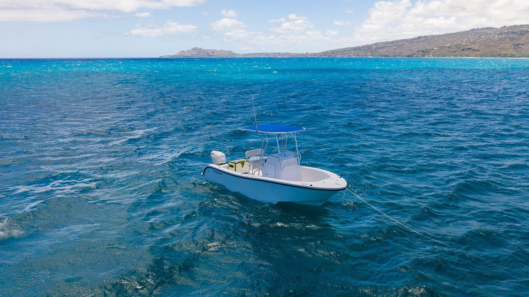

Yes originally it would have had up to twin merc 255hp based on the 351W for about 500hp before accessories. My earlier goal was to build a Ls making around 500hp. However, I’m probably going to be limited to 450 for now unless I swap an intake, stroke to 383, or supercharge it.
i was hoping to get dual performance out of it without the initial cost, upkeep, and weight. Somebody along the line swapped it to a 200. I can only imagine what a dog that must’ve been. The deep v soaks up the power. I may buy a kicker as a backup but don’t expect to need it.
I was debating real hard building a 383 when I got this 5,3 for free. kinda wished I’d had a 454 to stroke to 496 or 502 or even a 6.0 but I’m sure this will work. Calculators state Hooked up to bravo 3 should get 60. I’ll be ok as long as I get there at max and the boat rides as designed. But I will say, I’m going to miss the deck space. It was huge with that outboard but just not how Carl Mosely designed her. But I have plans for that area…

Ty my son is learning and we are making memories. He’s thinking about being a tradesman so might as well start now. He’s the XO and one day the boat will be his… I hope this will be in the family a long time. At least until we can afford a bigger one😂
bad… they grow wings and swarm in spring after “cold” months around may-June. After dark they will coat all lights. They will mate, shed wings, and tear up your stuff until the next spring when they multiply again. Houses have termite inspections, tenting, and as you saw not even the boat was safe. That’s why I used thermolite (Aussie version of coosa). I’m not sure on the boat. I think I’m one of the few guys I know of. But the wood just wasn’t sealed well and you asking for trouble here.
the glass was good on the 4 squares out front but the side portlights and side triangles are plexiglass and must be replaced. The bow rail is good but the tees and feet need replaced on bow rail. They were just plated something and not true stainless. But the rail is stainless and polished up nicely. The aluminum frames were scratched and had scrapes or gouges in them. I couldn’t get them out. So I primed with rust oleum aluminum primer and then painted with aluminum paint they seem to be holding up well.
