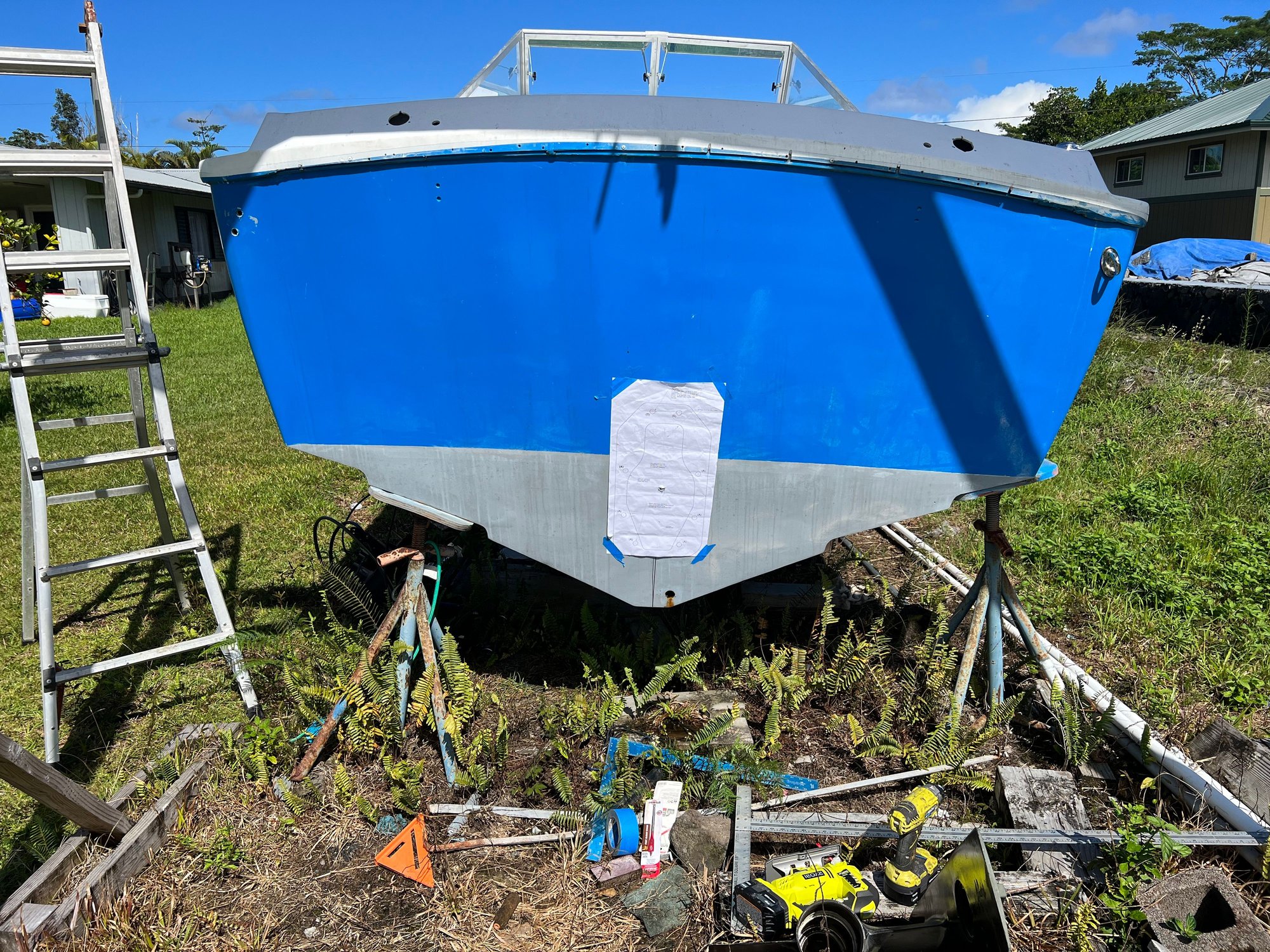

I need to cut the keyhole in transom. I’m very stressed about this for some reason. Probably that stupid x dimension. I’ll install the transom assembly and get ready to install the engine. After that I have a bravo 3 outdrive to do a rebuild on.

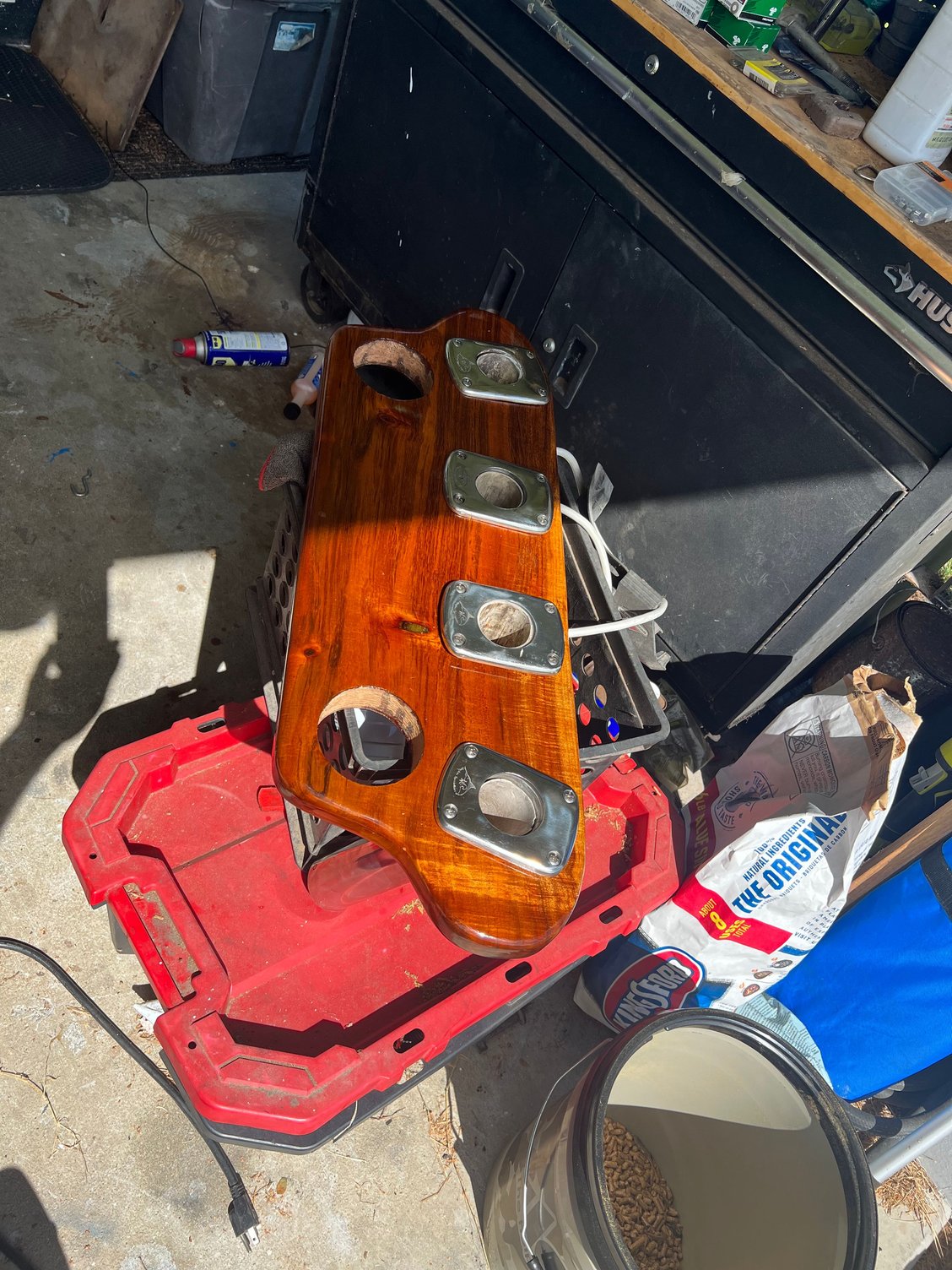

not much to report just a lot of busy work. But I am working on it. In meanwhile, here’s the curly koa rocket launcher I made for it.

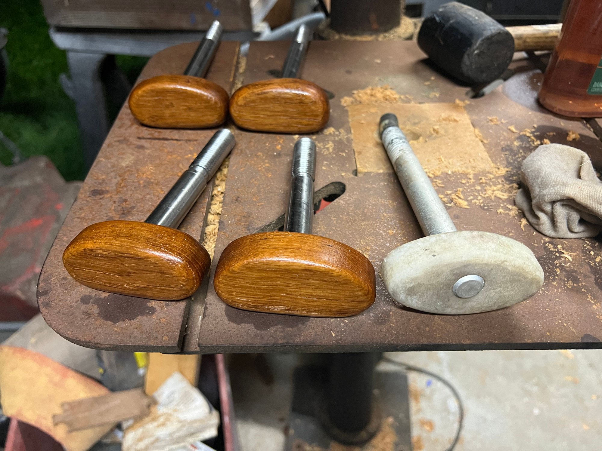

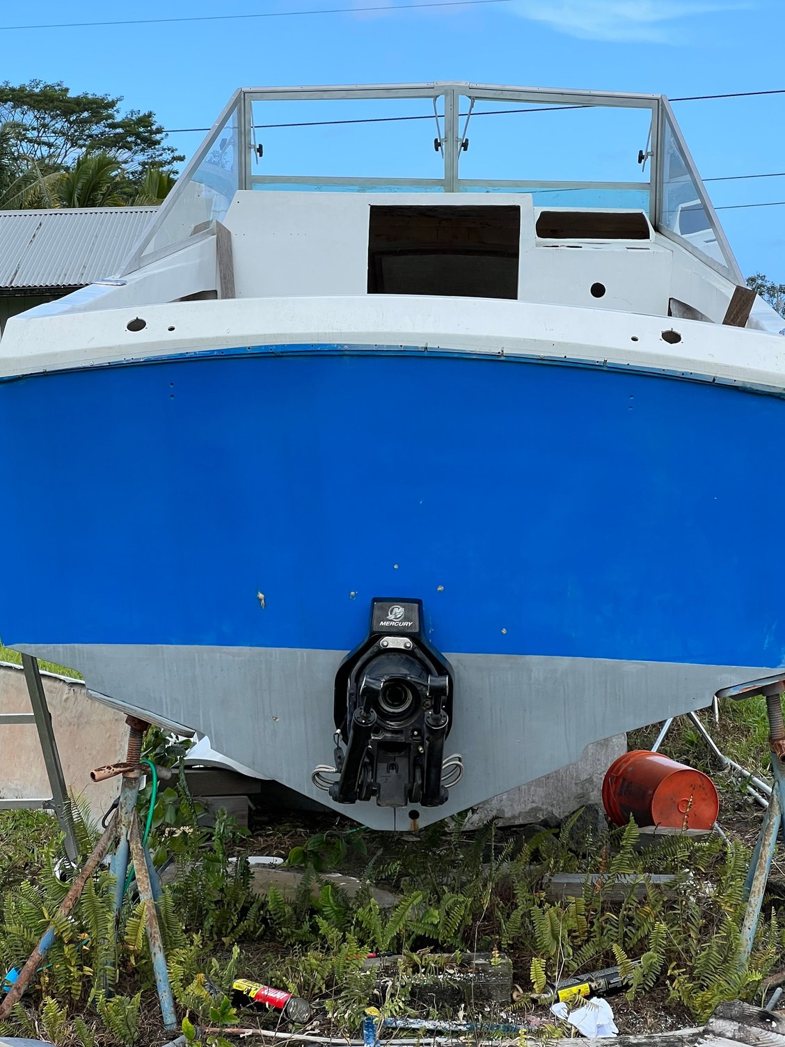

So here’s more photos of the busy work. Awhile back I cut the keyhole, waterproofed it, installed the transom unit, and made some new stainless screws and teak knobs for the original seats and pedestals. That’s an early pic of them in finishing. It took several days to get all the oil on and dry. Originally they were plastic some missing. These are mirror imaged for left and right seats.
