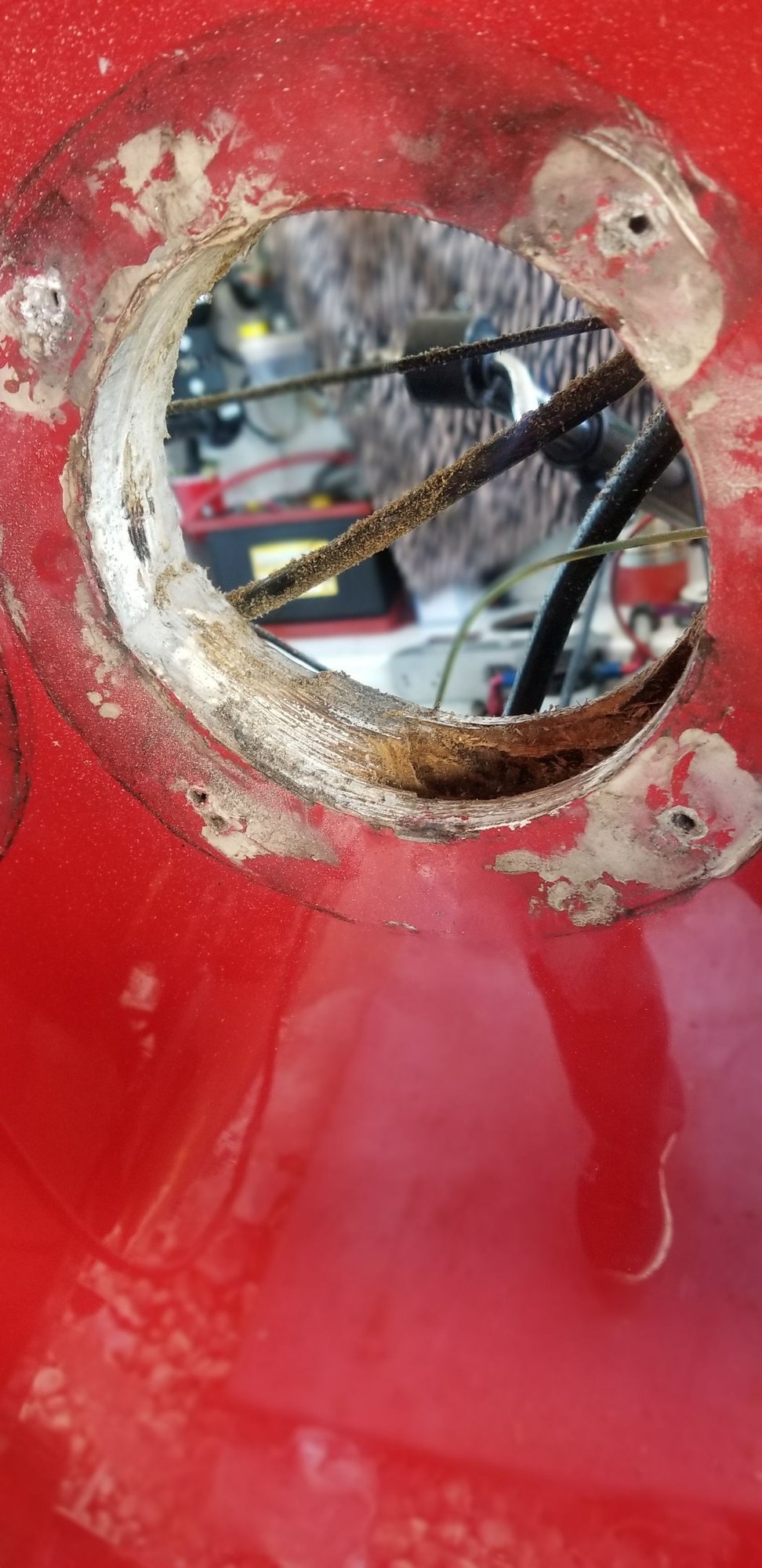

Originally Posted by boatnt
We are not stupid, we know how to prevent a water intrusion issue, treated like the picture I attached and you'll never have a problem, got it
I hope this was sarcasm. I can tell you from personal experience using whatever sealant that is 4200/5200 it will rub off with vibrations and this is what will happen. You can still see whatever white sealant the cheesedicks that I bought the Cig from used.
Resin and how Brad described it is the only right way to seal the transom.

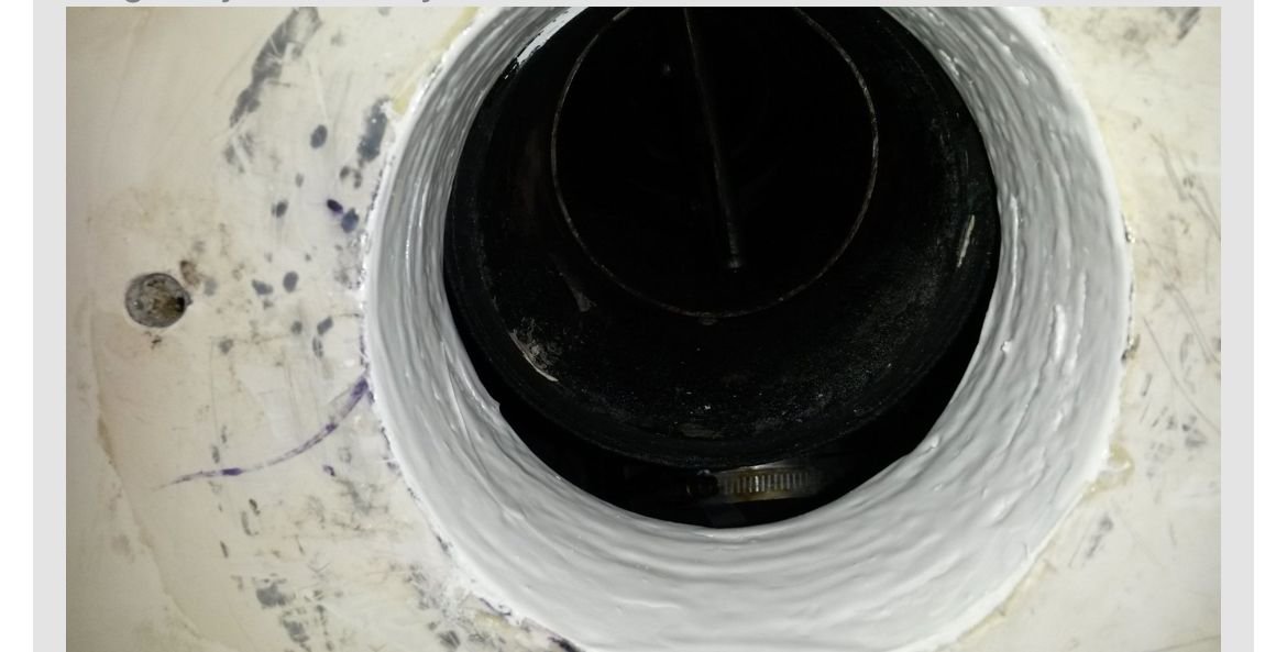

that is resin with white gel mixed into it, I oughta know it was my boat and I’m the one that sealed the tip cut out
