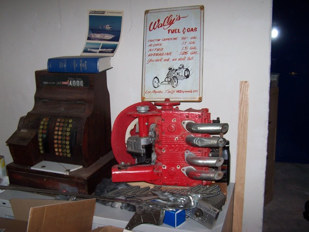

not a 450 but it is a mercury and it does have zoomies
compedgemarine is offline
