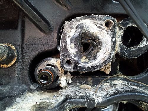

Old 02-14-2023 | 07:18 AM
Joined: Jun 2010
Posts: 4,839
Likes: 928
Have you checked drive for corrosion where hose connects?
1MOSES1 is offline

Old 02-14-2023 | 11:12 AM
Joined: Jun 2010
Posts: 4,839
Likes: 928
Originally Posted by Baby J
I haven't pulled the lower but when I back flush there's no restriction at all. It's worth a look though. Would that create bubbles in the system? It seems to cool ok at slower speeds.
not at the lower. It’s where tube is plumbed from sea strainer to outdrive in bilge. On the transom assembly
1MOSES1 is offline
