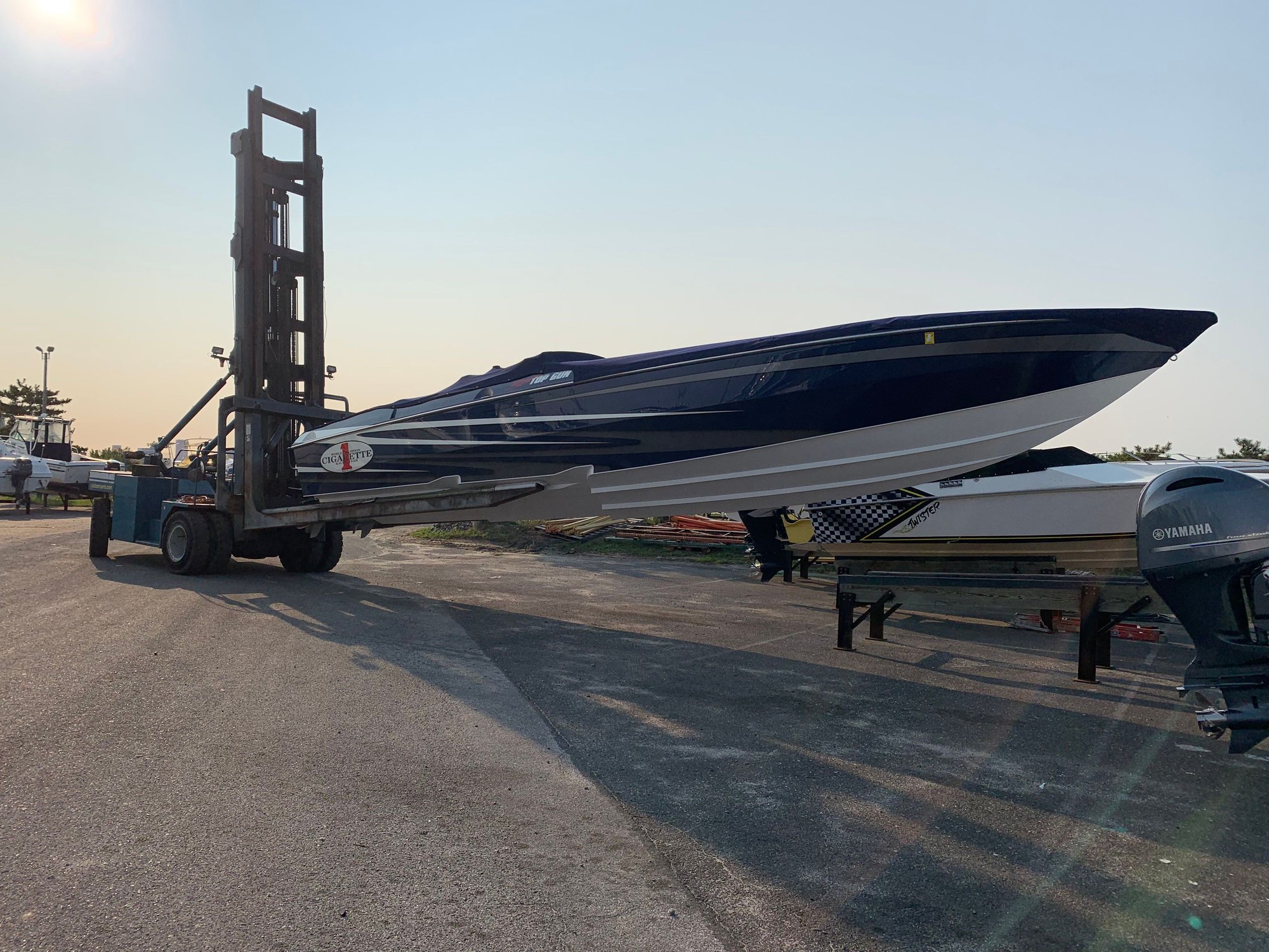

The lengths of the bunks don’t matter. It’s more important how they fit the hull where the weight is. Have you ever seen how they move boats around?
