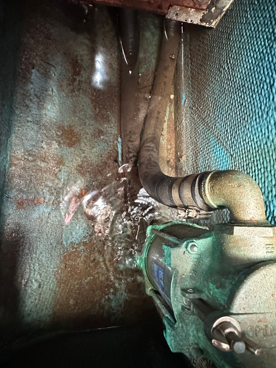

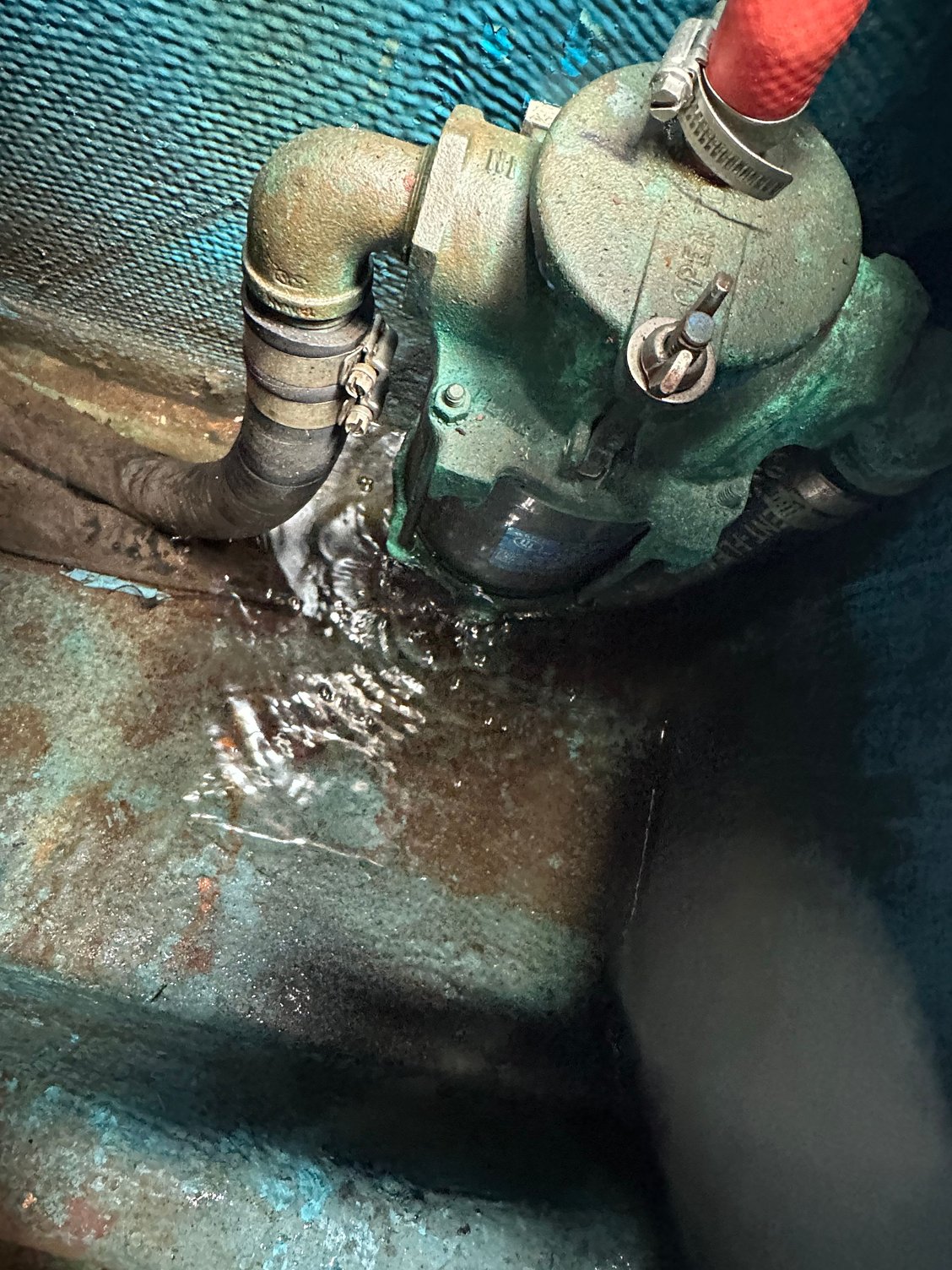

Not sure if this photo displays it or not but sea water is coming in and dripping off the bottom of them

damn...looks like more than a 'drip' to me! And yeah..I guess I always thought one could close an up-stream valve and shut off the water so one could clean them as necessary, at sea. Guess I have been wrong all these years.

That green shiit on there is bad. You have a leaky ground somewhere and the bottom is probably corroded.

Have same exact strainers in shed! I removed them because kept dropping wing nuts in bilge on old boat Glass or bottom seal cracked just a guess?Good luck merry x mas
