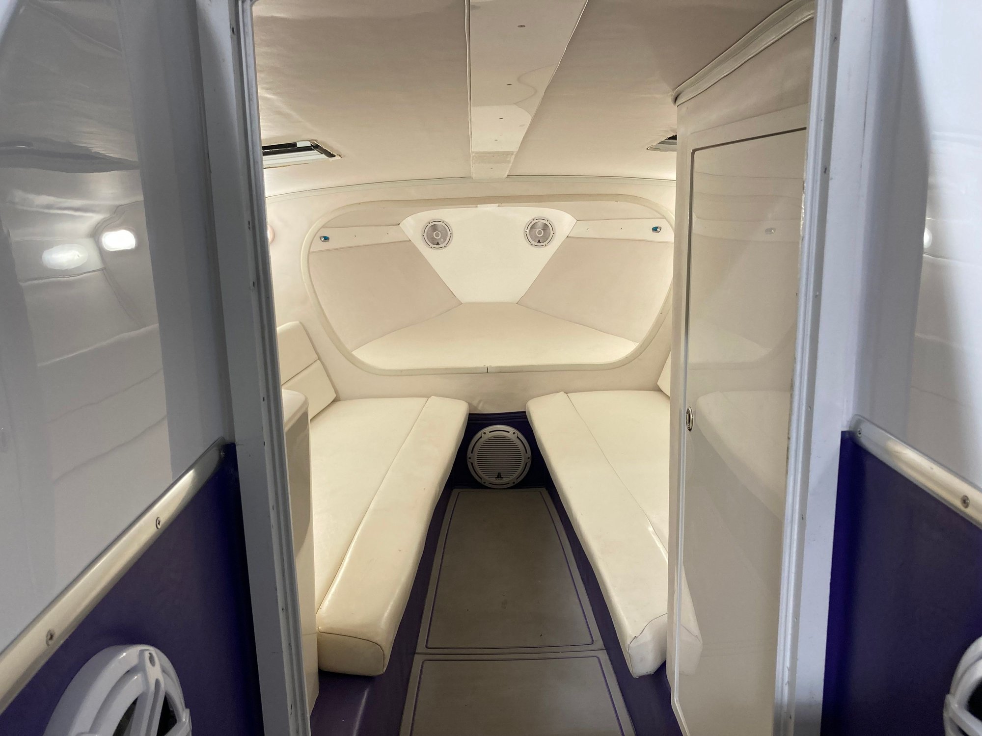

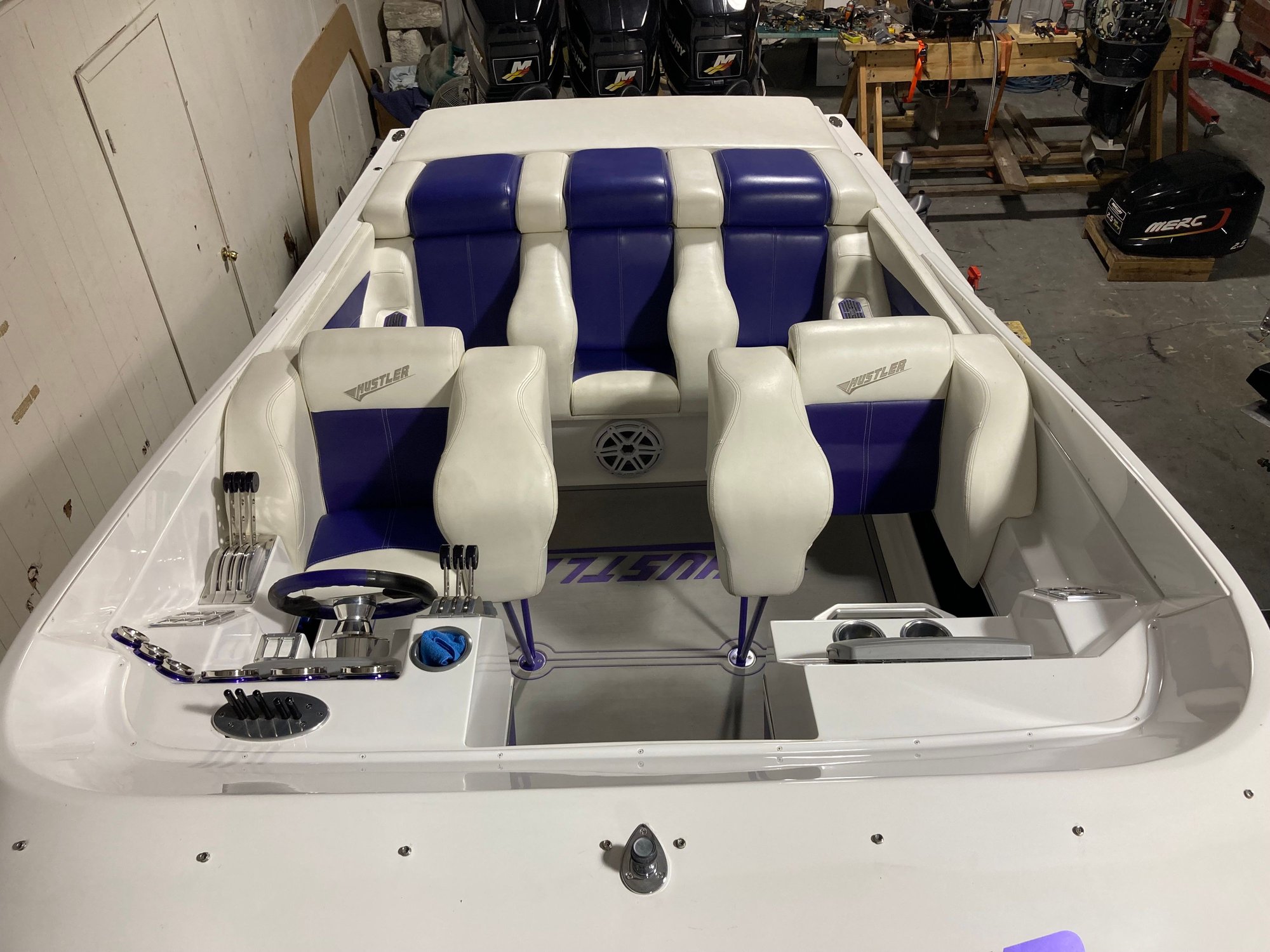

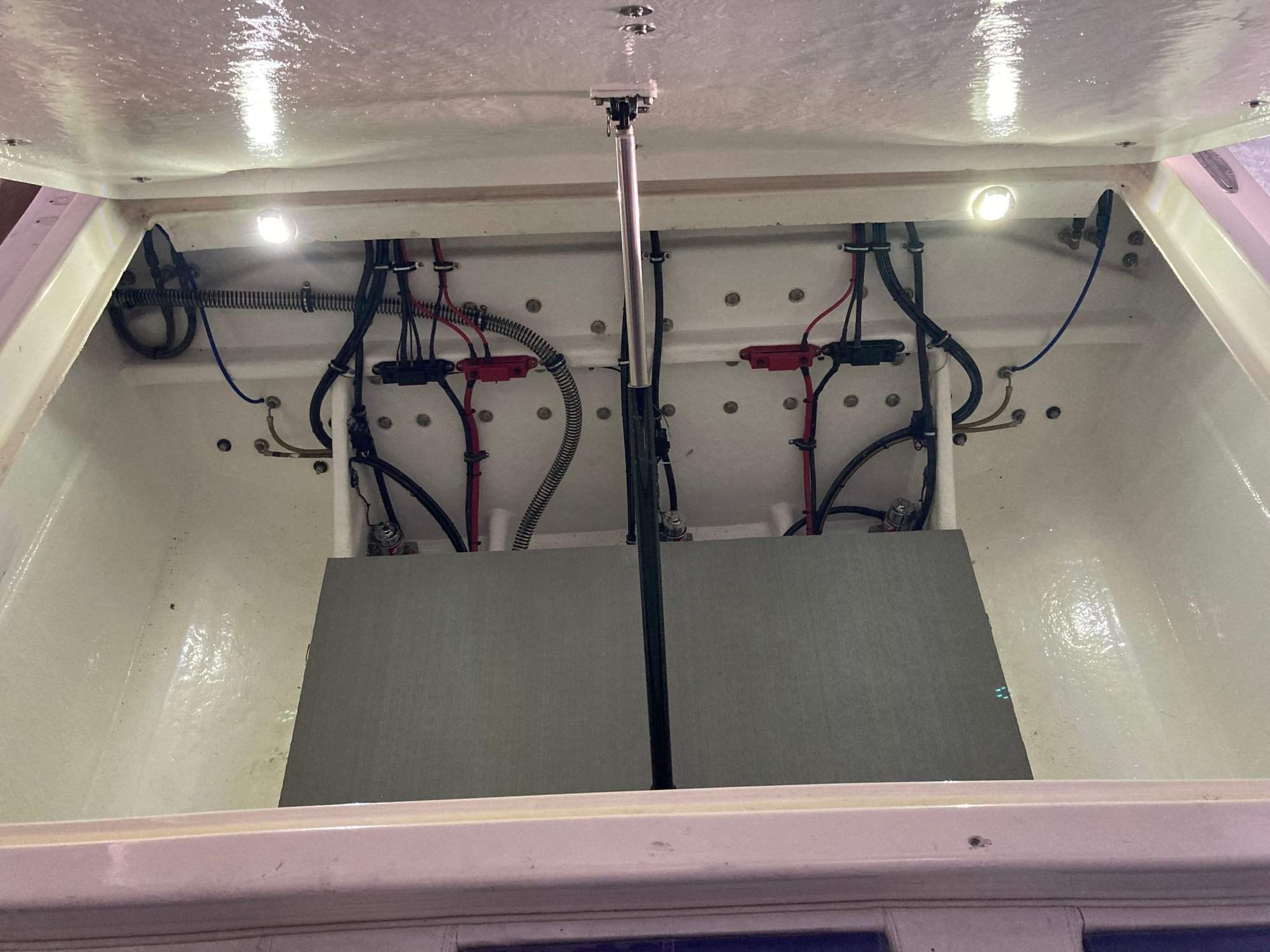

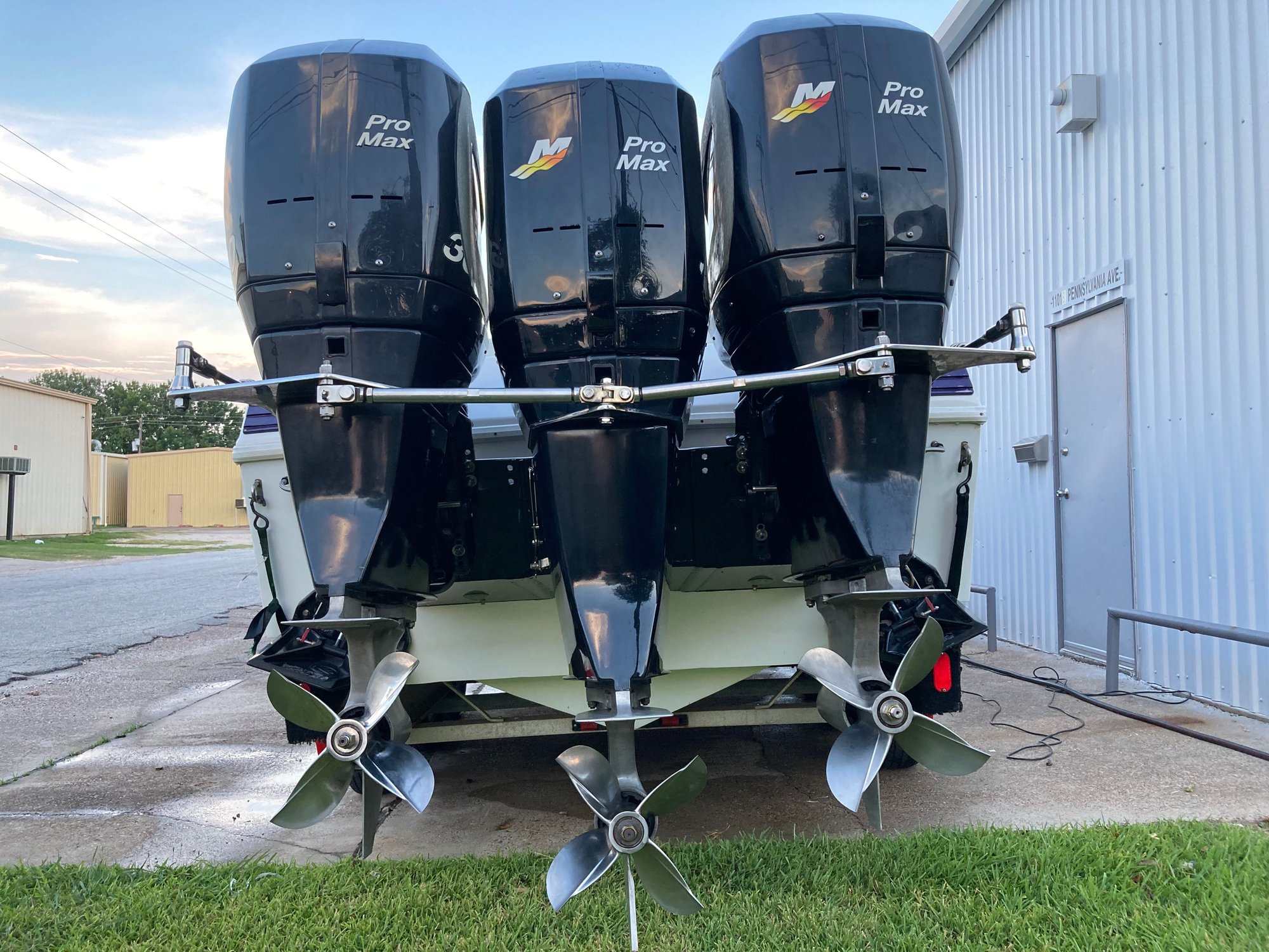

i do lots of custom restorations and yes when done correctly it gets expensive,,,,,,but is still way cheaper than brand new prices,,,all in what u want as stated,,,this is 1 of the last 32 hustlers that fiore made,,,,5 stringer boat and all foam cored with minimum birth with just cushions so is one of the lighter made as race/pleasure even had the built in stand up bolsters,,,,i cut up dashes and redesigned for 2 garmins,seperate lathem shift/throttles,pop ups and raised and angled the helm to make it sit down all new upholsty ,all new tank and floors,sea deck,awlgrip paint blueprinted and regelcoated bottom,custom transom ,custom made motor boxes,tripple 300 mercs,12 jl speakers,3 ampms with fusion on nema,,,ect,,,,boat is light and fast as the 32 was a fast snotty water boat to begin with,,,34pitch props,,,,70-75 at only 35-3800rpm cruising all day,,,,,100+ at 55-5800 and goes past 110 with ease ,,,i set it up for snotty water not max speed,,,all in wanbt u want,,,,and just got on water last summer,,,,love it ,,will sale to start another resto
