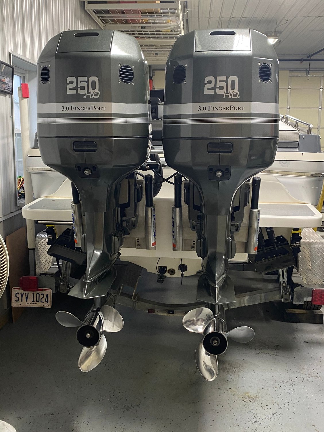

I've done it twice, 2 strokes, and 4 strokes, absolutely worth it. Many pluses. I do though like Gary last post...do everything myself except paint. Cg issues non existent when you figure it out and rig accordingly.

If you have a sound hull that you love and can't afford a more expensive newer boat, it's worth it. Built is better than bought, rewarding and not to mention different. Like any major decision in life. Pros and cons and weighing of cost and time.
