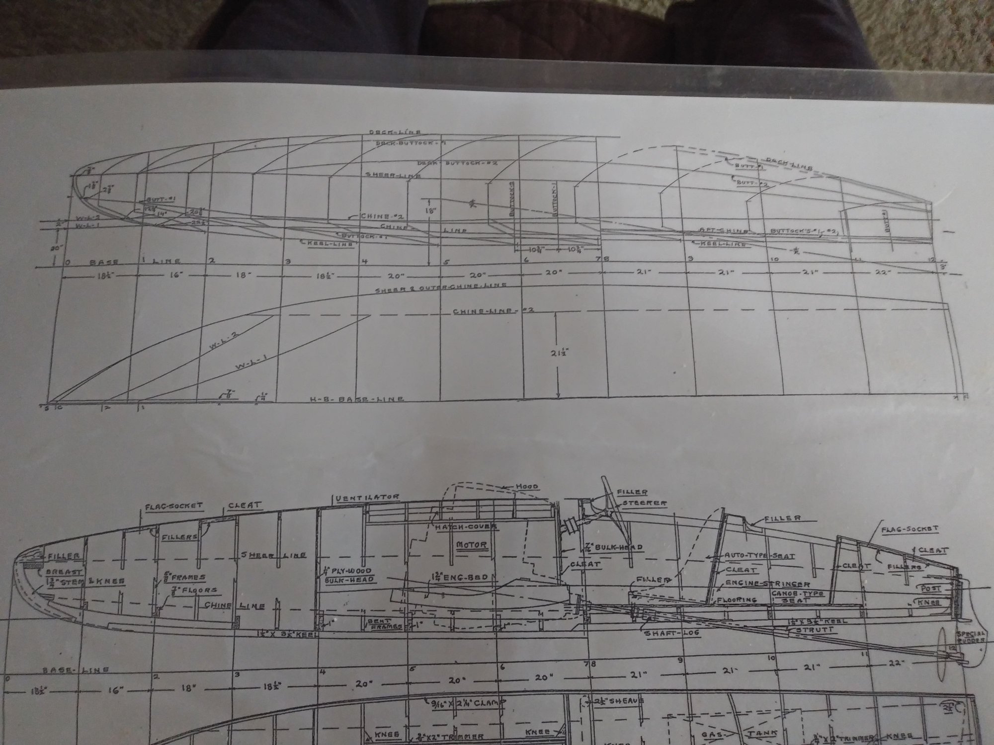

so I have to ask. what is the boat? looks like an interesting hull.

The boat is a 1928 John Hacker design 225 class racer. This design is for 18ft 6 inch long boat. I scaled it up to 25 ft. and added beam to make it two passengers wide.

Thats cool, those front engine models are bad A$$
