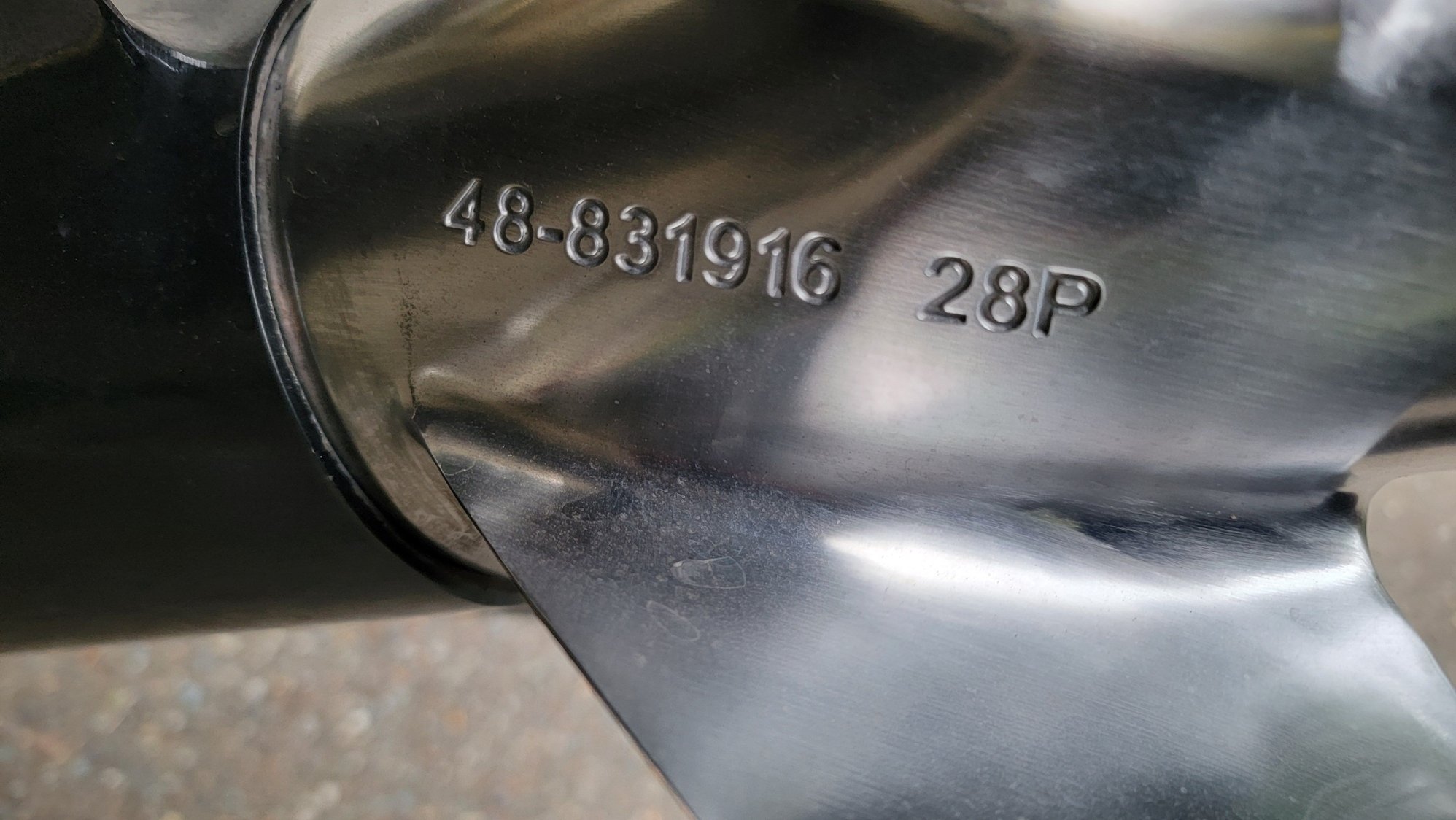

Here is a pick of my 28 pitch bravo. I need to order a prop and wanted to try a 26 or 27 bravo but I need to know if this is a standard prop or if it had been worked on. Need to gain about 500 rpm.

A lot of places will stamp the hub under your castle washer if its been labbed. I can't tell in the pics. Bravo's only come in even pitch unless you order a factory Merc labbed one.
Dropping 2" in pitch will gain you about 400rpms.

I am trying to learn as fast as possible so what i come up with is this,
Current prop appears to be a stock bravo 1 28 pitch. It is turning 4750 to 4800 rpm. I think a 27 pitch pro finish would be close to my 52-5400 rpm goal? I found a new one on ebay for 1000 bux.
