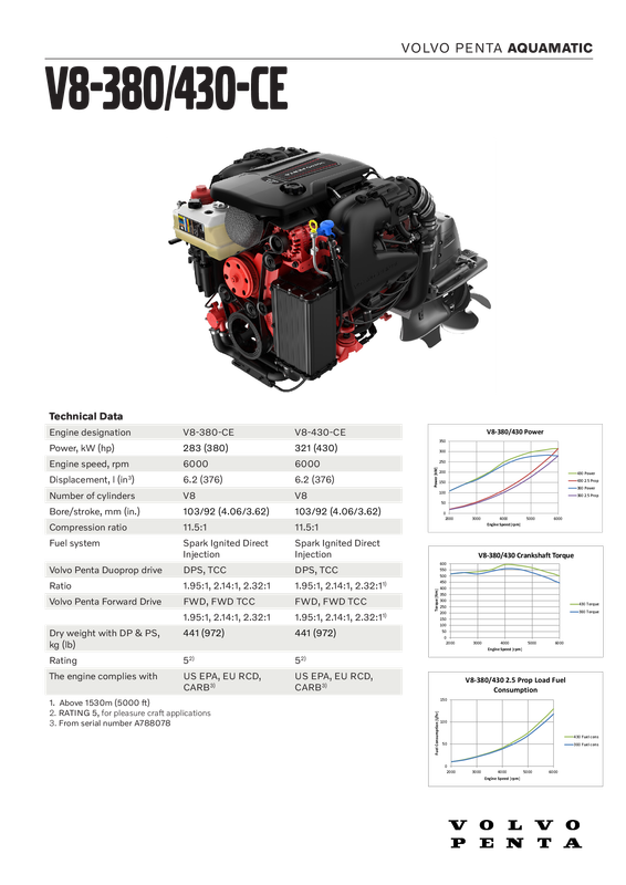

Would be Merc. 8,2 HO any better in your 9000 lbs hull than Volvo Penta V8- 430?
No way. VP have beter efficiency and it has a better torque curve on the propeller and in VP it is classic LS3 (Ok, now LT) with 2:1 gear.
Inadequate drive ratio is the main reason for the poor success with LS engines reported in this forum. It is understandable that the industry will not develop drives with a gear ratio of around 2:1, if it has a solid solution in the BB, which rotates more slowly and therefore has more torque on the main shaft. They did develop outboards 300, 400, 500 hp, which have wery similar rpm-torque engines like LS. And work good for heavy boats if you put a lot of them on the transom.
I have a 5,000 lbs 30 ft speedboat with LS 376/480. With a 1.6:1 gear, it pulled like a snail and was only conditionally usable. With a 2:1 gear shift, it's at least on par with the old Merc. EFI 500 engine, maybe even more powerful. I don't know, I'll see about that next summer when I get more familiar with the speedboat and can safely run it up to full speed.
I already wrote somewhere on this forum that the propeller takes power from the shaft with the fourth potency of the diameter (This is why it is sometime better to have more slip and smaller prop diameter, but even better it is to change gear ratio to have smaller prop rpm and bigger diameter.) , the third potency of the revolutions, the scuare of the pitch and the first potency of the working area. This applies to all propellers rotating in any fluid. Even a quick look tells that there is a whole potency difference between the revolutions and the step, and this bothers you with the LS!
With a classic B1 drive, you get around 4,000 rpm on the prop shaft, which is way too much, so there is no torque to turn the propeller. If you reduce the pitch, you are affected by the square, and the revolutions punish you by the cube...
It is necessary to go to a gear ratio around 2:1 and then no BB can beat an equally powerful LS engine in acceleration, top speed and consumption.
