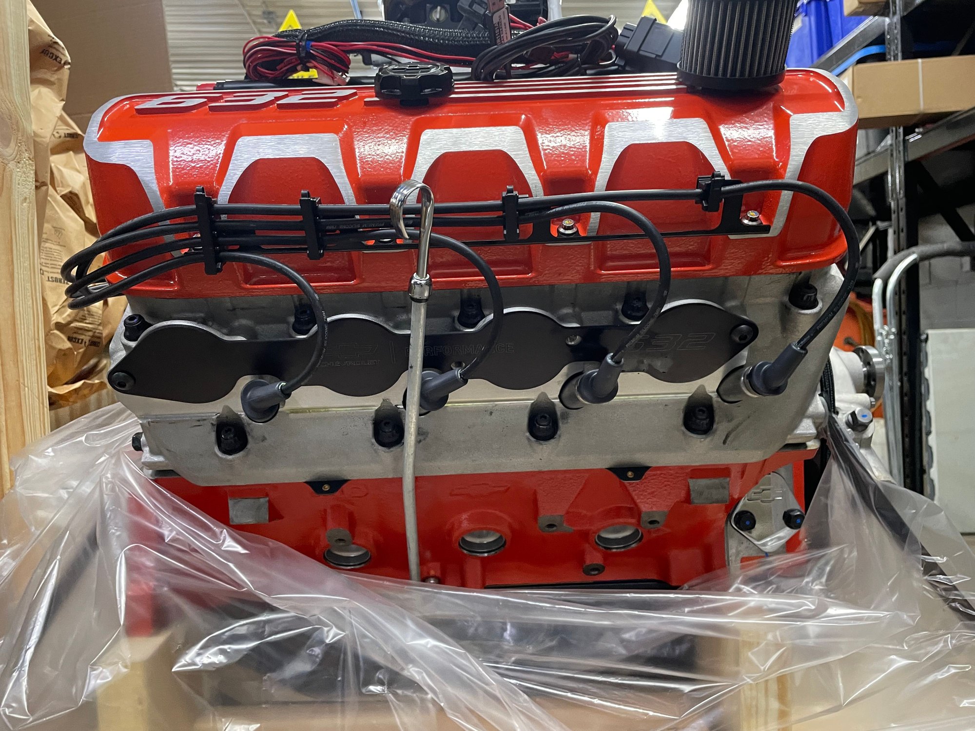

Just got 2 of those nice engines!
what are the marine engine builders comments on that engine in a boat?
