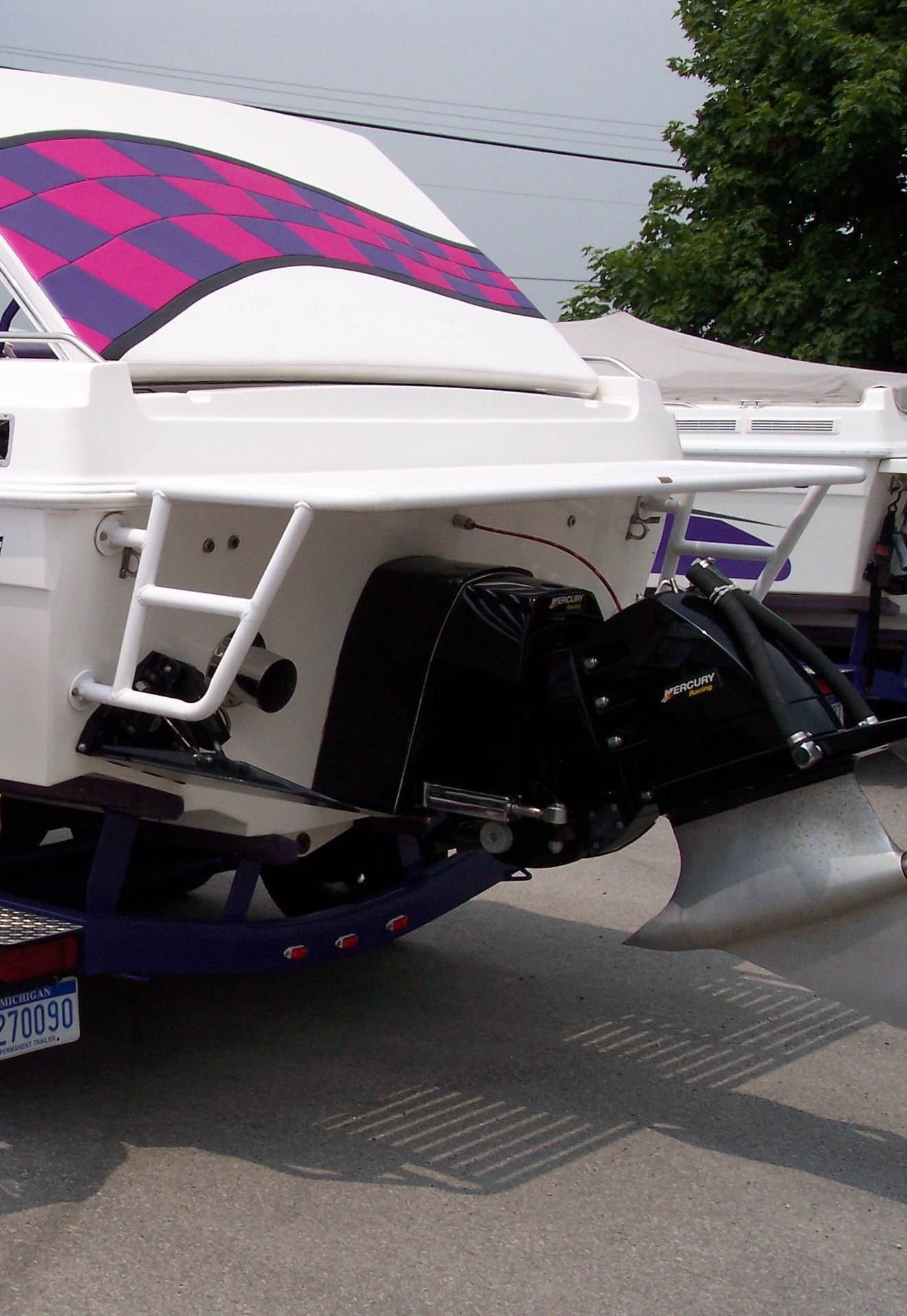

I can't find any good pictures at the moment, but Check300 on OSO here had a sweet single 30' Checkmate with some huge power twin turbo single and a single M6.

I used water cooled heat shields to control the temp under the engine hatch.
