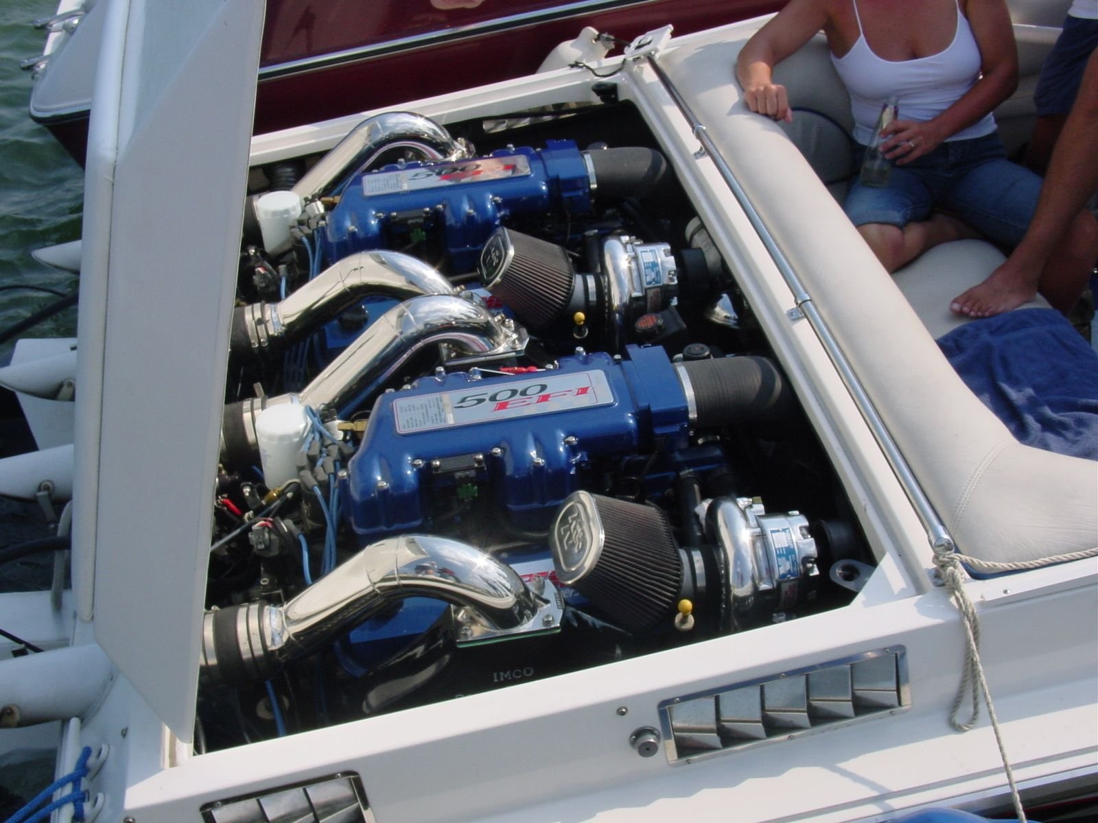

Oh heres a pic of that 28SS with the 500Efi motors....i forgot they were procharged too!! You can see the boxes barely in the back there....all white...

Thats not mine...it was a guy that i believe used to work for Gaffrig (before they changed to Livorsi) It was at a fun run up to Racine WI back in the very early days of OSO :) Dont know if he still has it or not...was a cool machine for sure
