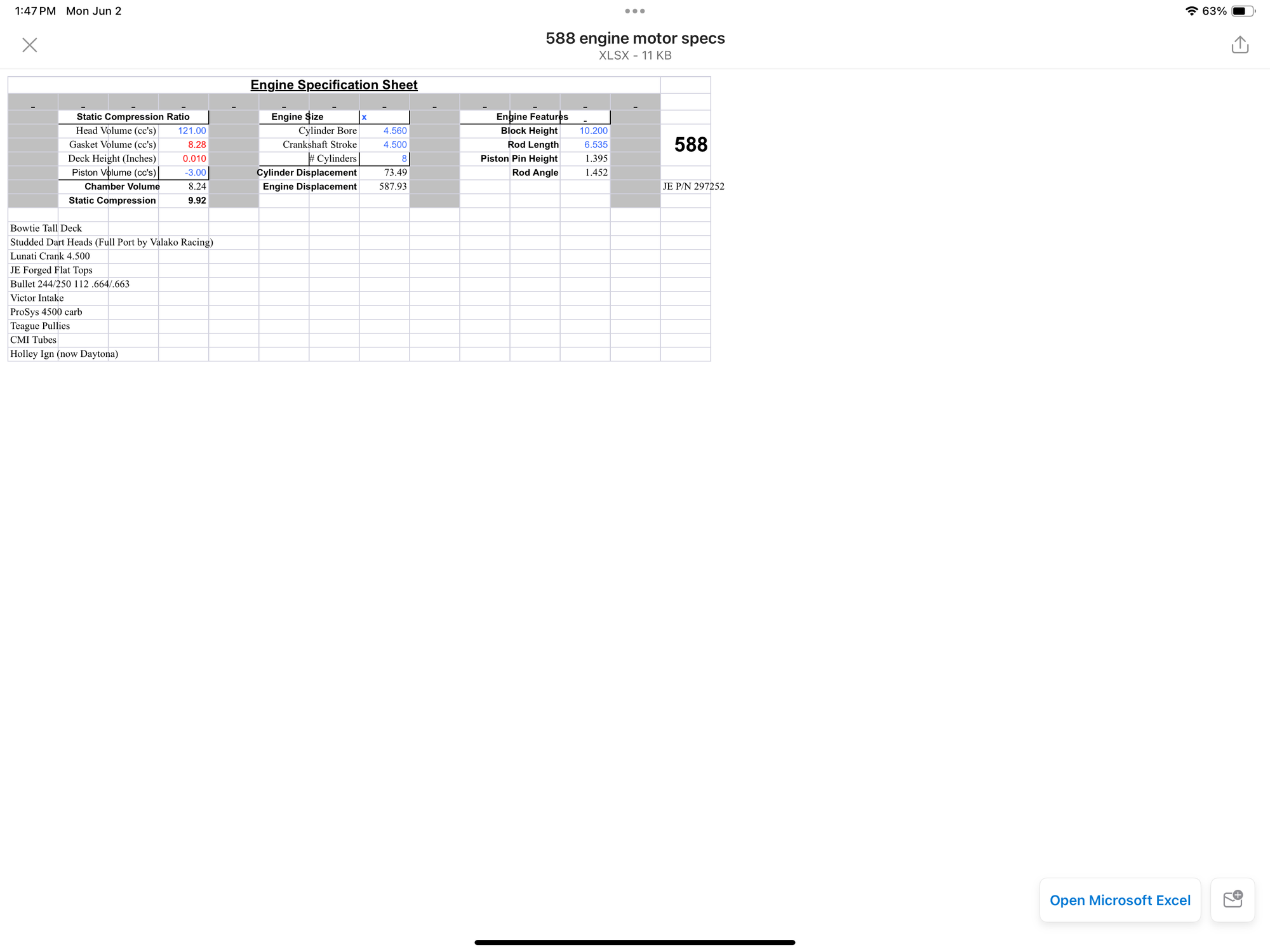

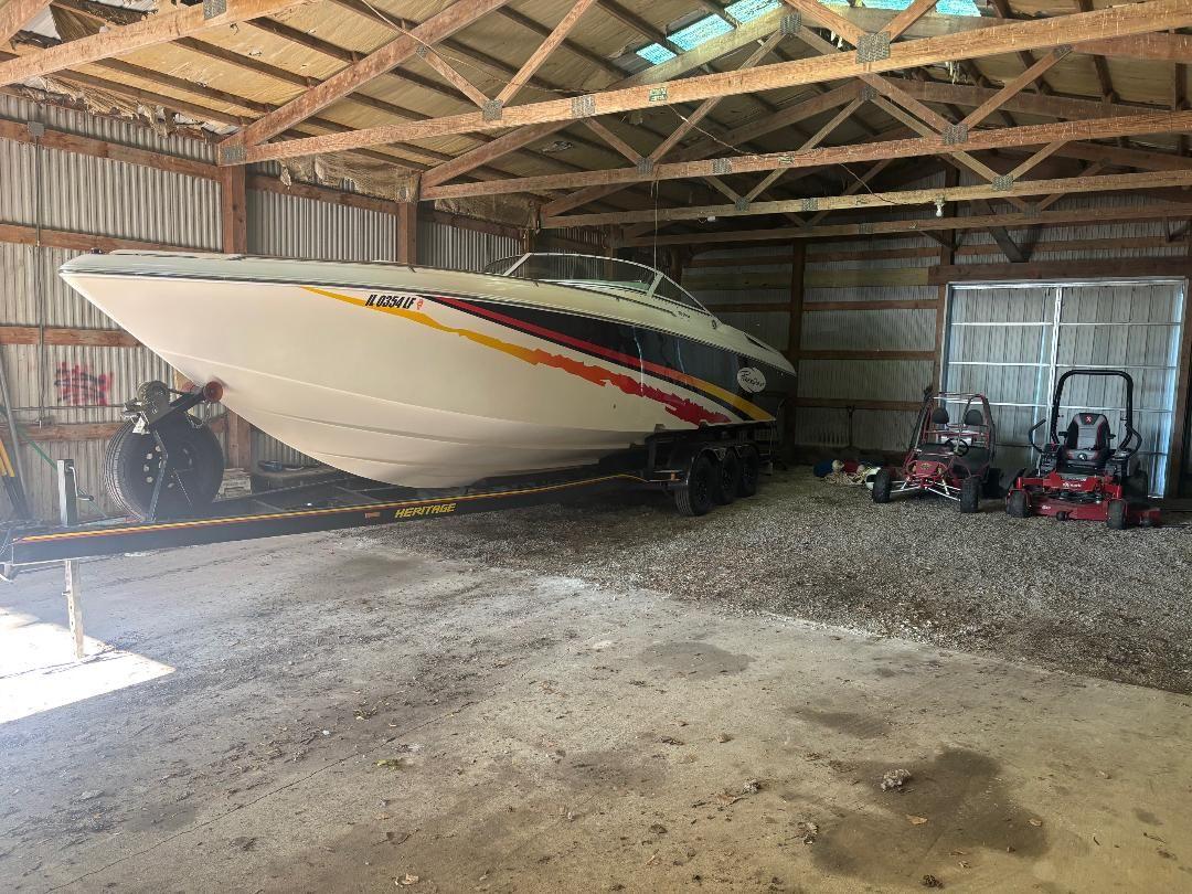

I dropped the boat off at Wesco Racing this week to check out the power in the Powerquest 340 Vyper. It runs normal in all ranges except WOT. It's down around 500 RPM at WOT. It planes normally, runs normal in midrange just can't spin the motors as fast as last year. I brought it to Dave at Wesco to make sure something isn't broken. Compression test was fine, plugs looked good so I'm assuming valve springs and or top ends need to be freshened. The motors have just shy of 300 hours. They are NA 588s. I'm going to try and run the boat as is until the Fall and freshen up the valvetrains. I really appreciate Wesco getting

Just my own fat ass. I'm up about 10lbs from last year. Are the 340s known to trap water somewhere? It's a 2002 twin step. It will still do 90mph at 5300. Last Spring it would pull 98mph at 5800.

Moving out for a V bottom. Details on engines?
