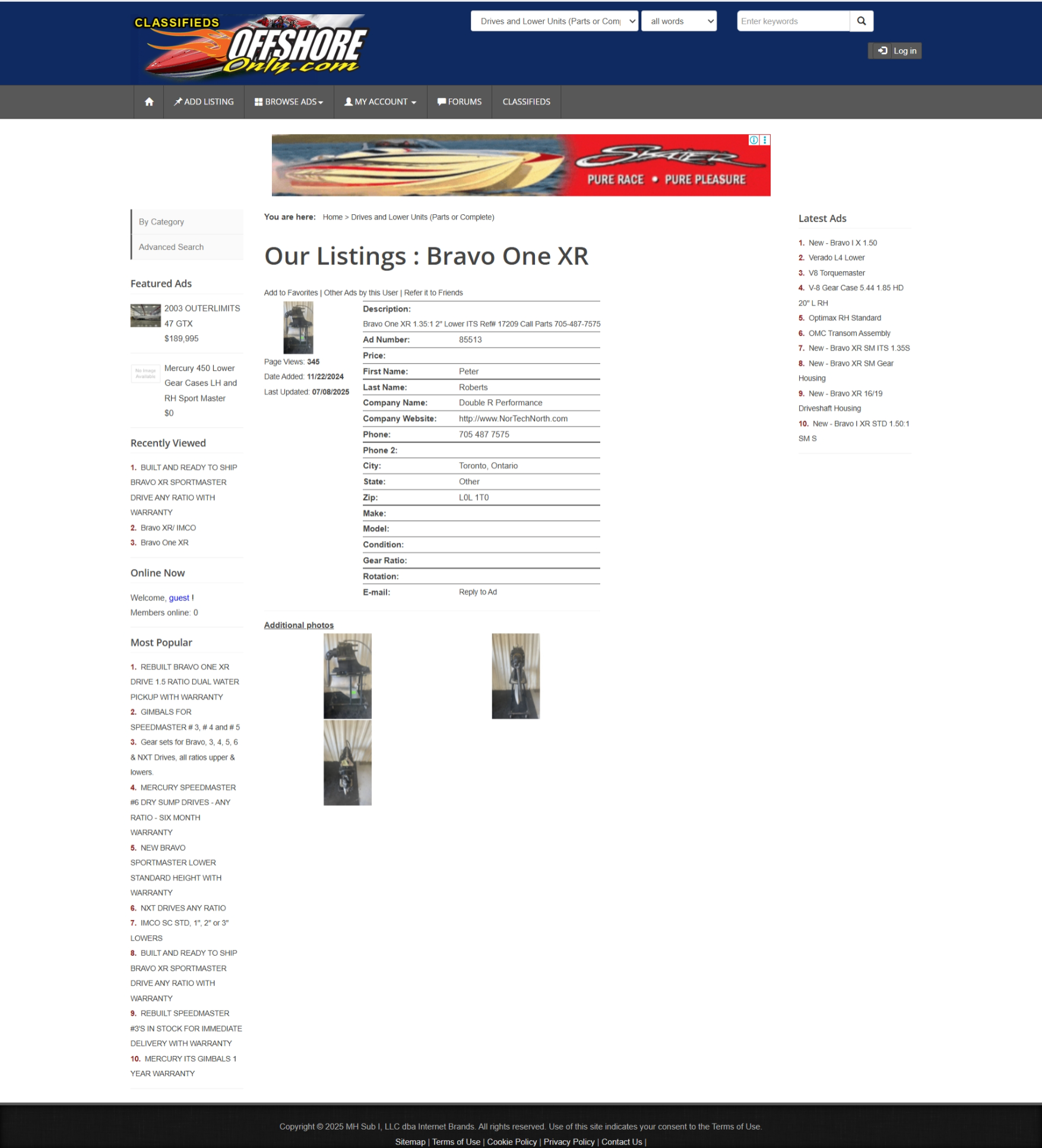

What gear ratio should I be looking for with the 502 and Bravo drive setup, 1.50:1?

Old 07-10-2025 | 12:15 PM
  #32
Veteran: Merchant Marine
Joined: Jul 2025
Posts: 33
Likes: 9
I was looking at this.

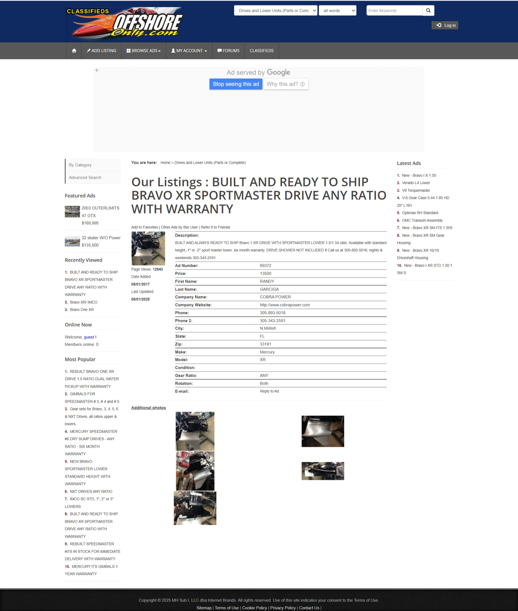

Likes: 9
Also this...

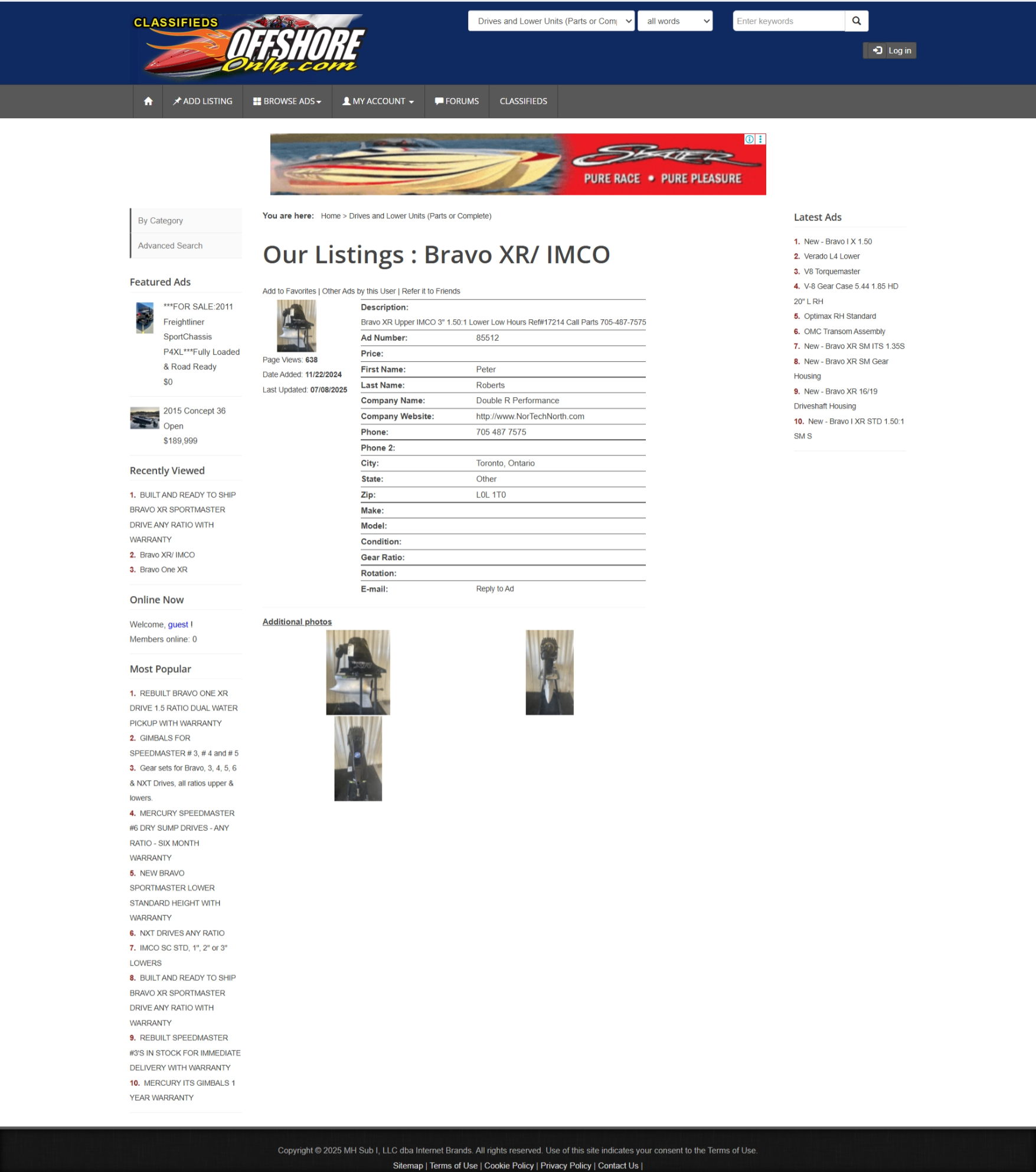

Likes: 9
There was also this 1.35:1

From: Midwest & T-Rock
You will not be able to pull a 1.35 gearing with a 502 mag mpi, or probably anything less than 700 hp.........the 1.35 is used when the 1.50 runs out of prop and rpm ( limiter )
