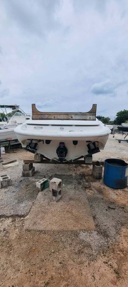

This. It was common practice to simply drill holes and run lag screws into the stringers for the engine mounts. I also understand they simply cut the holes through the transom for the drive and exhaust and bolted everything together with silicone and a prayer. I just can't imagine.
JonD,
You would do very well for yourself to thoroughly inspect every attachment point that went through wood for water intrusion while you've got everything out. One dick's opinion.

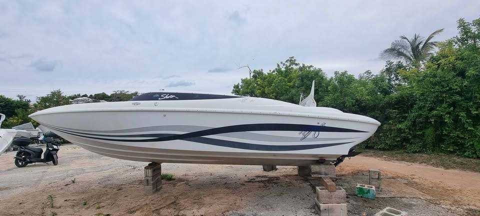

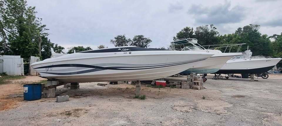

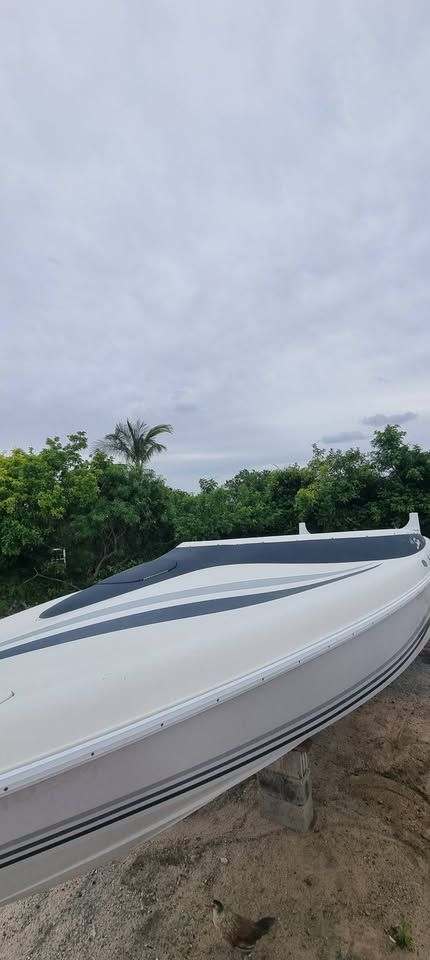

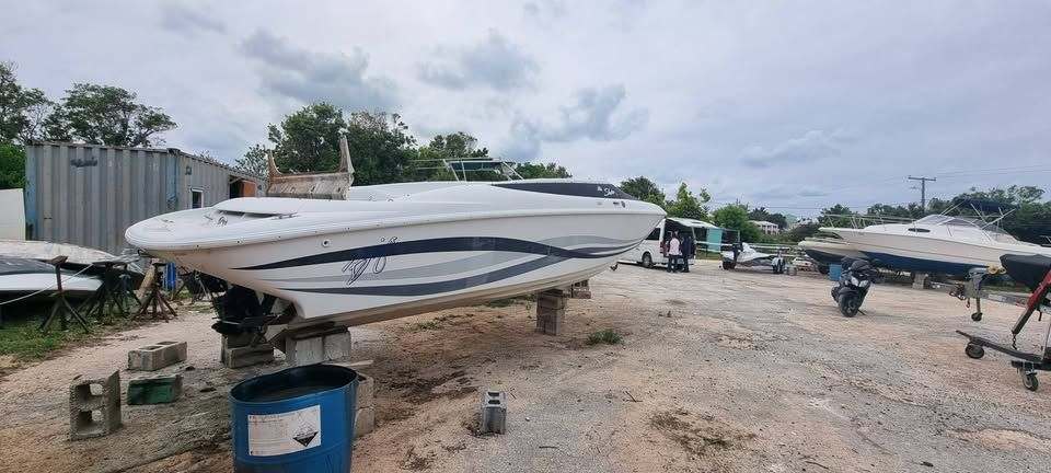

If its been setting uncovered you need to check it for moister / rot...........before throwing a bunch of cash at it.........where are you located ?
