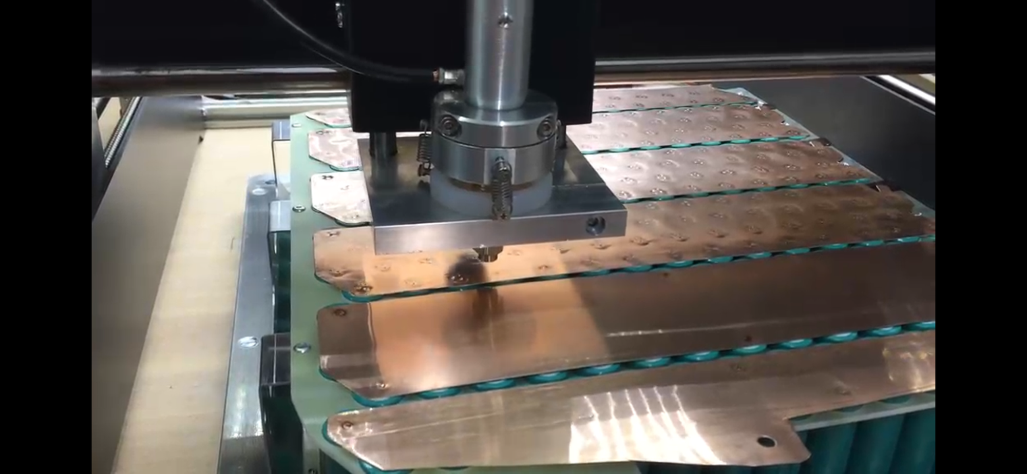

the welding of the cells was actually not that big problem. I will attach a video where if possible, a CNC router did the welding. I just found this video now the speed was much faster after some time.

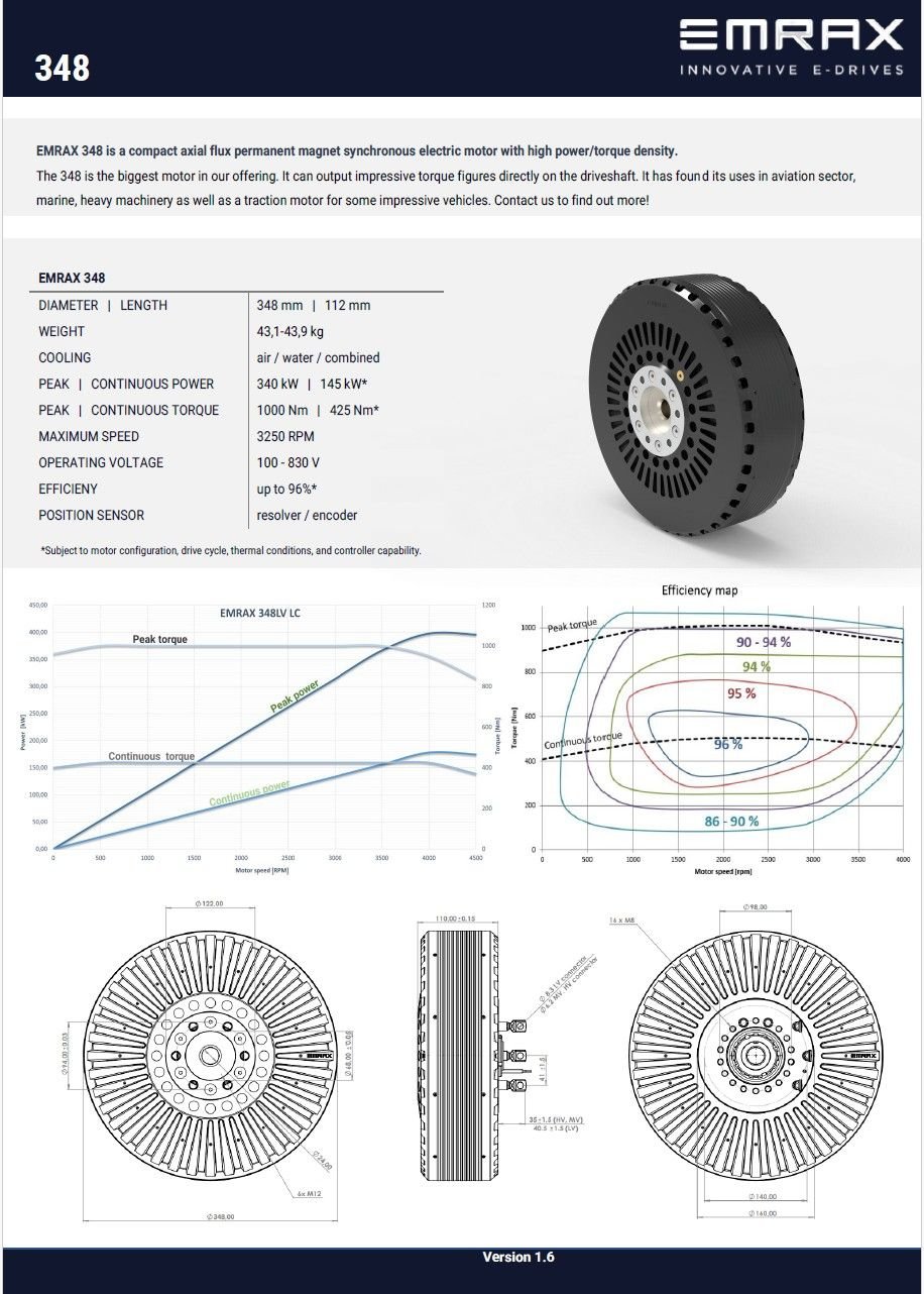

Conerning the motor design, my thought was that the motor should have similar torque and motor speed then most boats with Z-Drive have at the propshaft. The problem is that all motors I found on the market have higher motor speeds. If you take a Tesla Motor eg. it has about 15,000-19,000 rpm, so gears are needed to get the propeller shaft speed down(3500 rpm) and torque up. As far I understood from my motor bike experience gears take efficiency and most times gears do funny sounds, also gears have a live time and need service like oil changes. I just repaired my rock hidden TRS lower gear housing on my 33 cougar and the oil situation was a real mess. Back to the motor, the only motor I found was the EMRAX which has also lower speeds. But the design is not really what could be under water. The price of the Emrax is also not really cheap and then I would need to build around another housing to use it under water.

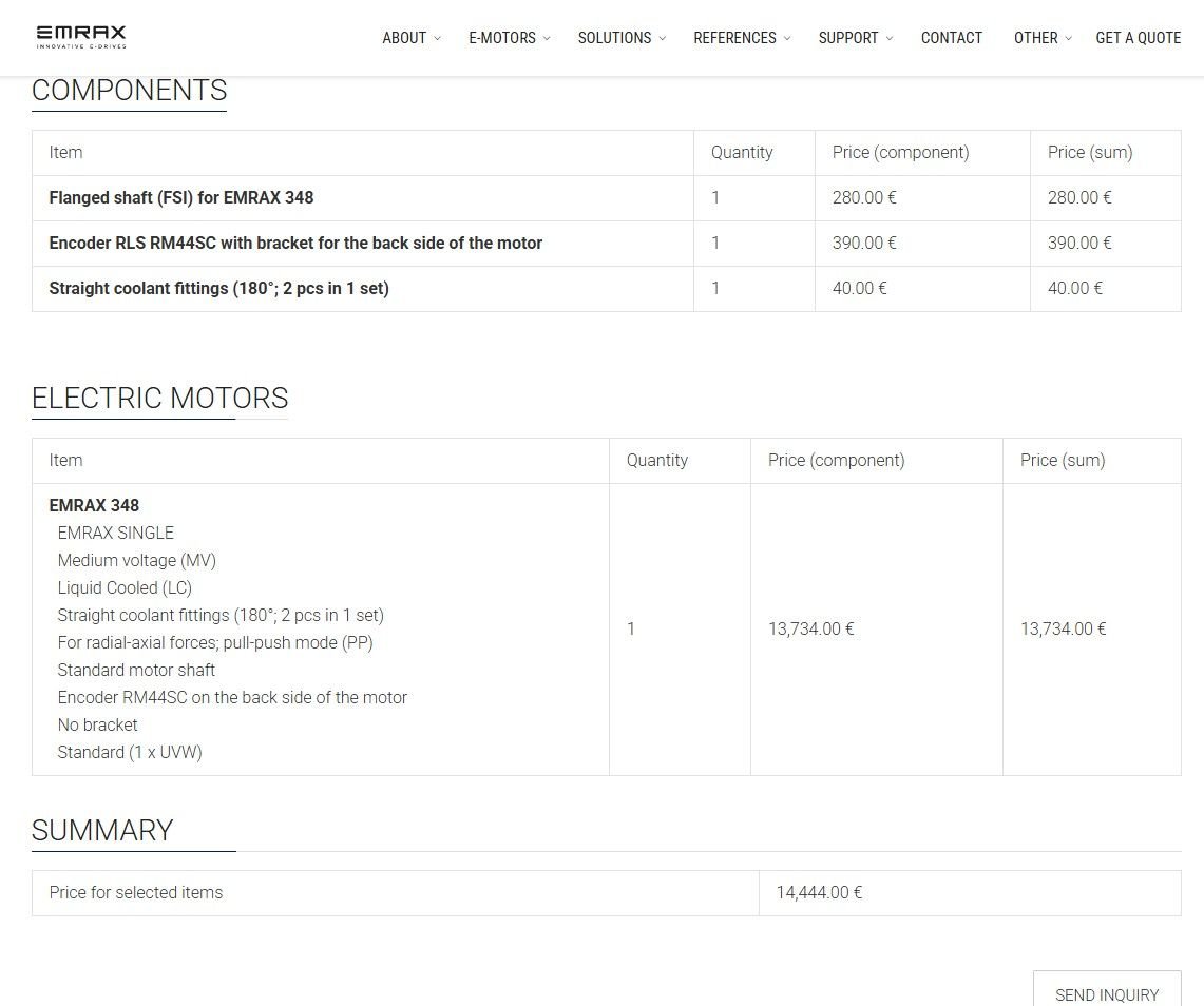

@ Andrew and Smarty: I will attach the offer and the datasheet of the Emrax. Probably you know it already. Offer can be automatically generated at the Emrax homepage (www.emrax.com). Without controller!
